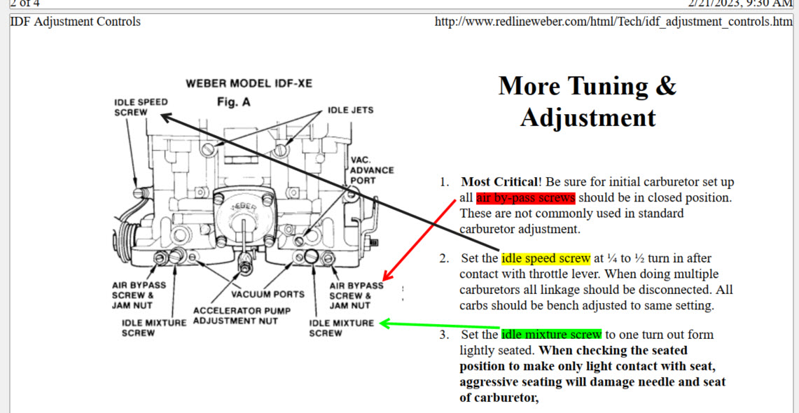

malcolm2   Found some time last nite and I re-assembled the c...   May 3 2023, 07:48 AM
malcolm2   RE: Dual Weber IDF 40s   May 3 2023, 07:49 AM
Superhawk996   Good find. Usually you’ll only have 1 air bleed...   May 3 2023, 08:19 AM

rhodyguy   Tomlinsons Weber book p.22 ….’pre-set your air...   May 3 2023, 02:38 PM
malcolm2   Tomlinsons Weber book p.22 ….’pre-set your ai...   May 4 2023, 12:14 PM
nditiz1   Tomlinsons Weber book p.22 ….’pre-set your a...   May 4 2023, 04:44 PM
malcolm2   [quote name='malcolm2' post='3075791' date='May 4...   May 4 2023, 07:35 PM
