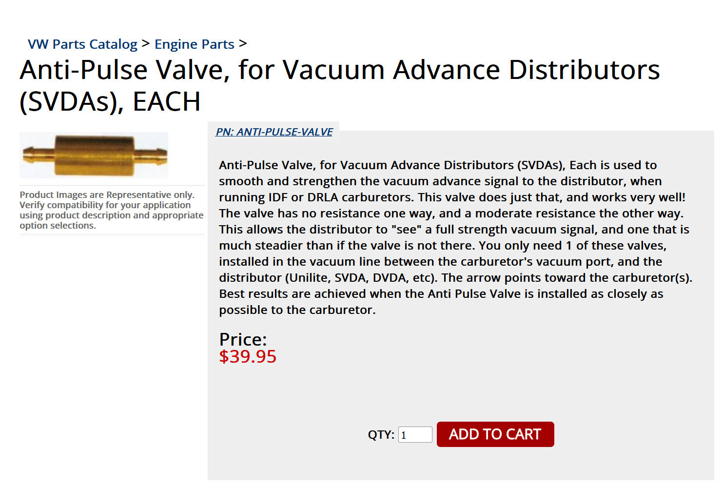

I do have a vacuum can on the disty. Both carbs have a Vac. Advance Port as noted above. They came plugged. I removed 1 plug and attached a hose to the vac can. I also have a 1 way valve on that hose or something similar. IIRC AC.net recommended the device to help smooth out erratic pulses.
