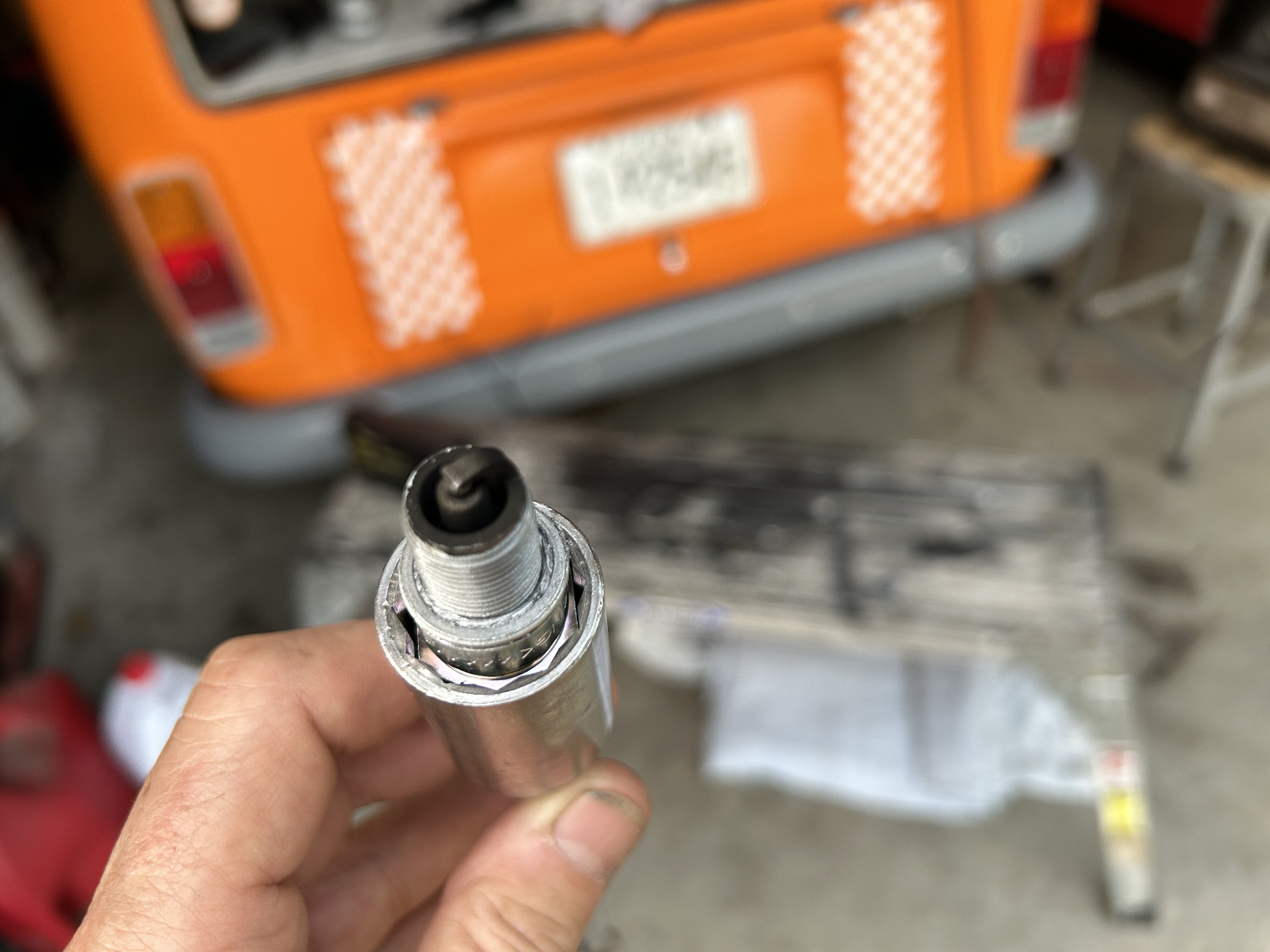

All day run with new plugs. Lots of adjusting etc.. but not DRY JET BLACK.

malcolm2   All day run with new plugs. Lots of adjusting etc....   May 6 2023, 06:56 PM
Superhawk996   You’re running way too rich Have you verified...   May 6 2023, 07:15 PM
malcolm2   You’re running way too rich Have you verifie...   May 6 2023, 07:46 PM
Superhawk996   look a bit lean to me. Gray?? There are also a...   May 6 2023, 11:11 PM
malcolm2   You’re running way too rich Have you verifie...   May 8 2023, 05:37 PM
