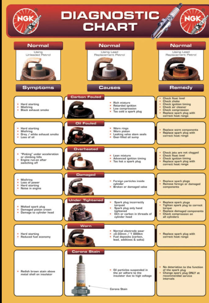

Superhawk996
post May 6 2023, 11:11 PM
Posts: 7,780
Joined: 25-August 18
From: Woods of N. Idaho
Member No.: 22,428
QUOTE(malcolm2 @ May 6 2023, 08:46 PM) *
look a bit lean to me. Gray??
There are also a series of small holes (the transition ports) that should closed and a few that are open or just obscured above the plate when the throttle plates are closed.
It is critical that you’re not running idle such that the transition ports are uncovered by having the idle speed screw set too far open. You want to make sure you don’t have the condition shown in illustration B when idling.
With respect to the plug condition, that plug is no where near a lean condition even when looking at only the insulator.
Here’s a plug visual reference
