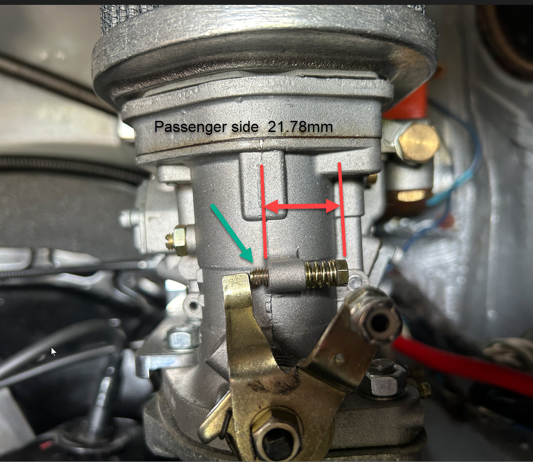

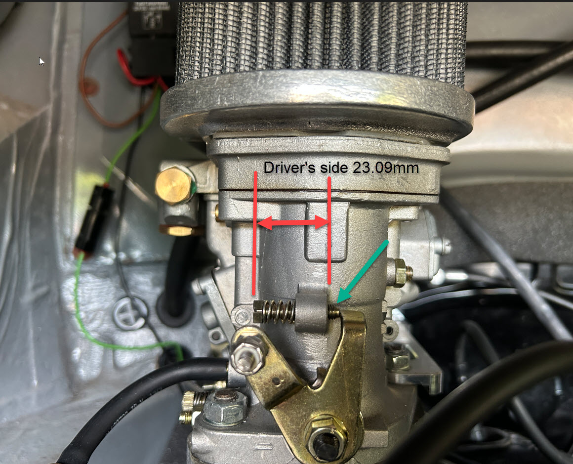

I found a way to MAYBE verify your concern about the throttle plate and maybe you are right, but how do I deal with it? As you can see from the last vid, all 4 barrels are very close in flow. So here is what i found.
It was obvious that the tip of the speed screw shows more threads on the PASS Side than on the Drivers Side. Wouldn't that mean that there is a chance that the plate is open past the port you showed me???
What can I do to make it close more and still run nicely?

Superhawk996   I wouldn’t judge by that 1.3mm variance in the a...   May 8 2023, 06:50 PM
r_towle   The throttle plates should be visible from above t...   May 8 2023, 07:13 PM
