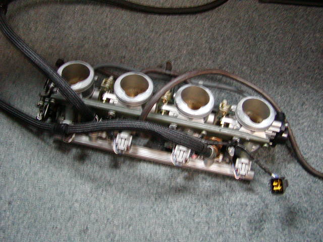

The cost of aftermarket throttle bodies is way up there, the bottom of scale we have the CB Performance units which are about $250 each and the rest are easily 2X that about.....
so I swung by the motorcycle salvage yard in Fremont today and picked up these beauties (IMG:http://www.914world.com/bbs2/html/emoticons/smile.gif)
45mm at the butterfly....they taper down to 42.5mm at the bottom...
includes a nice TPS and injectors...I doubt the injectors flow enough, but who knows, I'll find out once I get the specs....
no idea of what bike they came off of yet.....price was $125

DNHunt   Mike Are those grooves in the TBs for O-rings. M...   Jan 21 2005, 02:42 PM
Root_Werks   Using bike TB's like this is a great idea real...   Jan 21 2005, 02:54 PM
SLITS   I have a TB on my 2.0 that is definitely not stock...   Jan 21 2005, 03:03 PM

Jake Raby   I have done this twice! It works... That size...   Jan 21 2005, 04:05 PM
