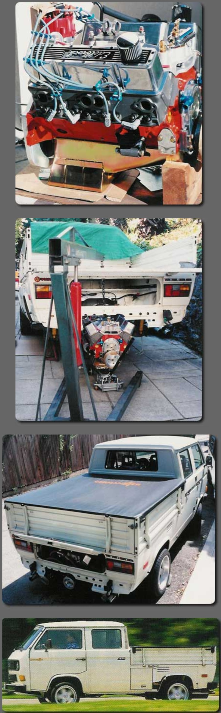

'85 Doka' with a sb 350" Chevy + g50 5speed is a whole different story

Maltese Falcon   @mepstein Found an MSDS Vanagon ('80-92) 3.2L...   Nov 12 2022, 12:28 PM
Maltese Falcon   Let's go for a ride in the dirt...in the dry-b...   Nov 12 2022, 12:34 PM
Maltese Falcon   Another pic   Nov 12 2022, 05:36 PM
Maltese Falcon   Under the bonnet :D   Nov 12 2022, 05:41 PM

Maltese Falcon   @anderssj that's my old buddy Dieter Wanderer...   Mar 21 2023, 08:52 AM
Maltese Falcon   "VW Trends" magazine, Dec. 1991; Dieter ...   Mar 22 2023, 10:18 PM
Maltese Falcon   The 1968 single-cab was formerly used as a Shoppin...   Mar 22 2023, 10:21 PM
Maltese Falcon   Few more from the article, pic 6B shows a very sho...   Mar 22 2023, 10:26 PM
Maltese Falcon   Last of the article pics...911 gauges on a custom ...   Mar 22 2023, 10:29 PM

Maltese Falcon   @VaccaRabite Zach...I never put a CIS engine into...   May 10 2023, 11:42 PM
Maltese Falcon   '85 Doka' with a sb 350" Chevy + g50 ...   May 11 2023, 08:13 AM
