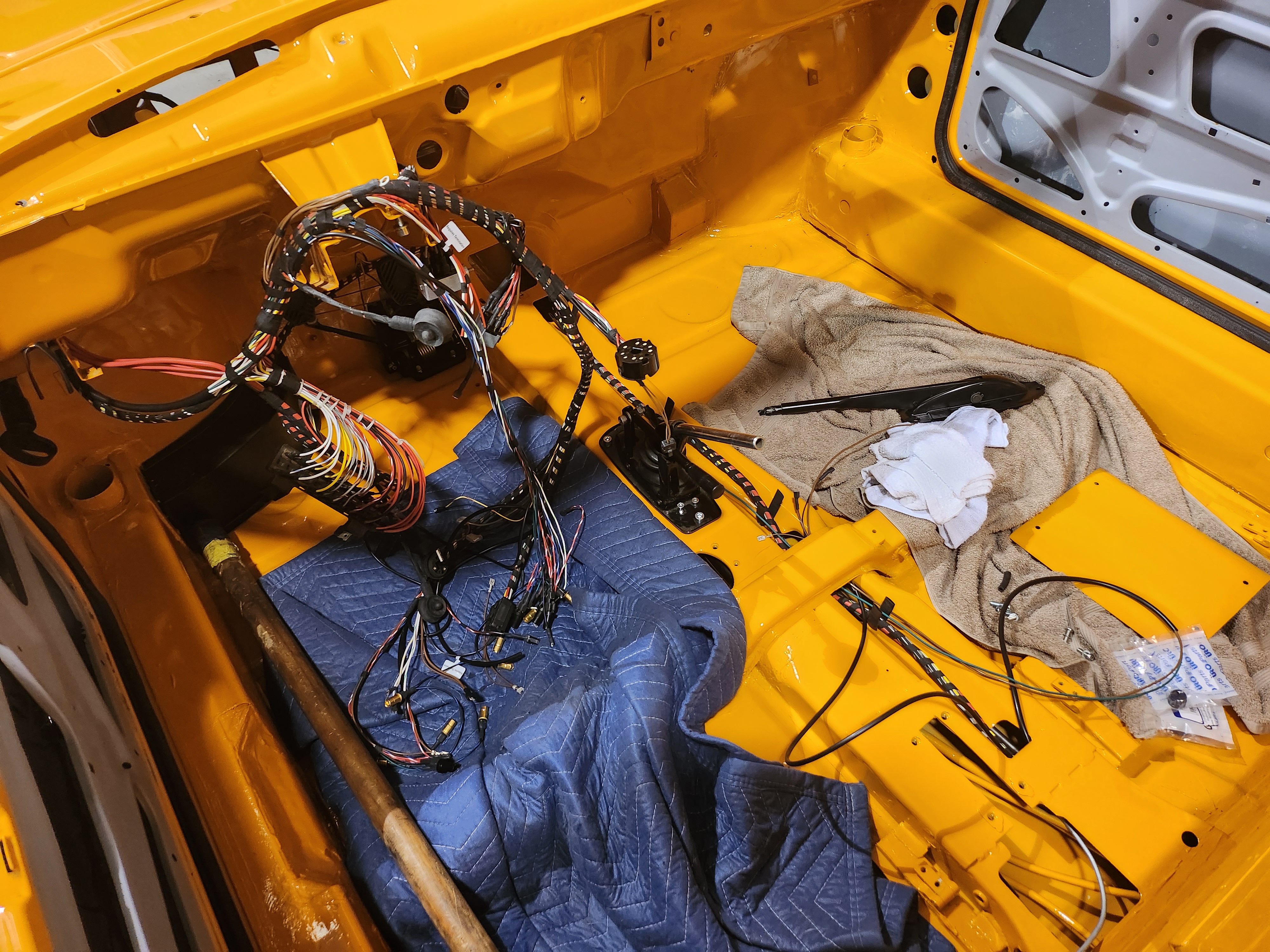

(IMG:style_emoticons/default/wub.gif) The Ronals ... Thanks for those, JT!
Making progress, harness is in, suspension is on, and while waiting for some parts restored the wiper system and started on the defrost/blower. Also fabbed up the fuel gauge binnacle which came out pretty nice. 60mm exhaust pipe cut on a 30 degree angle, tacked on a couple of washers as mounting points and sprayed with a little bed-liner paint.
