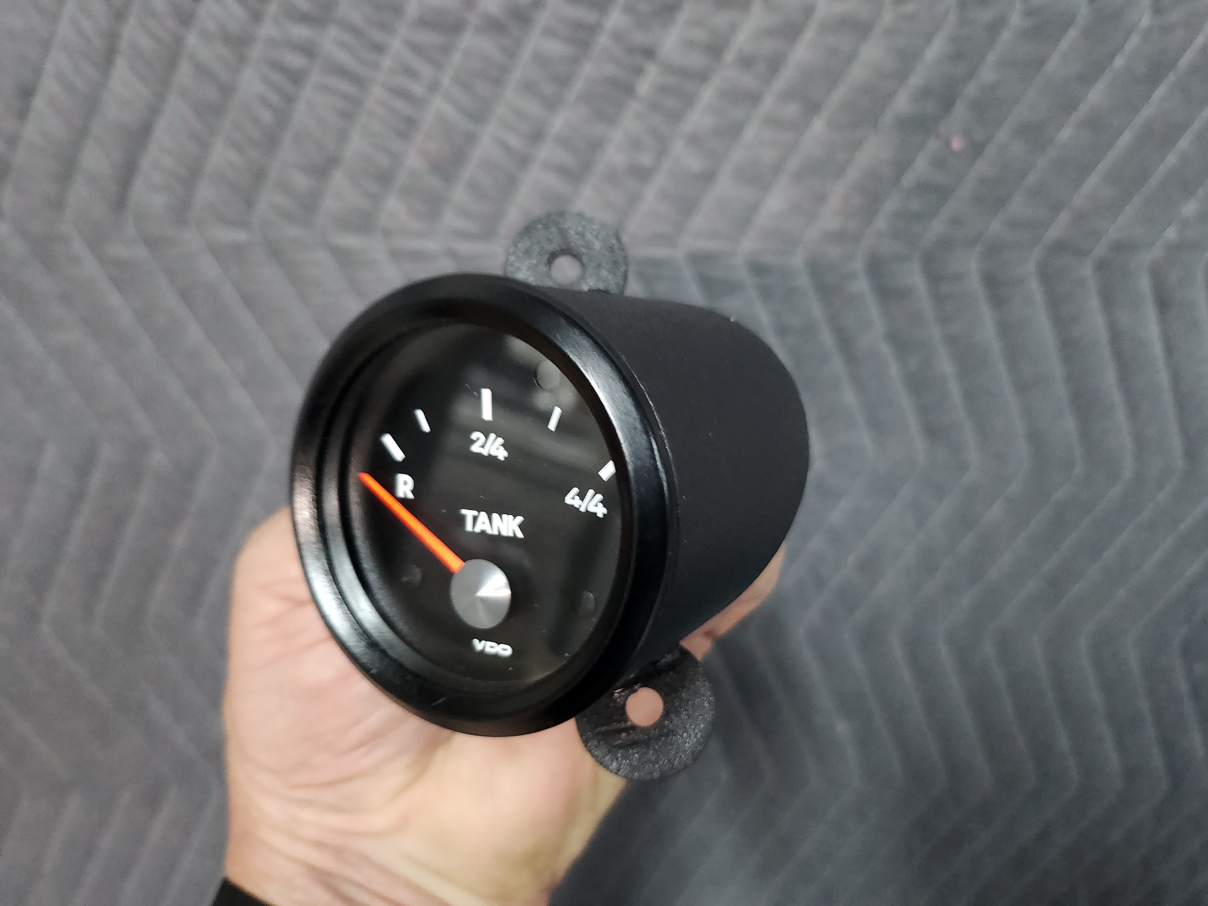

Bullethead   RE: 1970 914/6 GT Replica Build   May 15 2023, 07:44 PM
Bullethead   RE: 1970 914/6 GT Replica Build   May 15 2023, 07:45 PM
Dion   That fuel gage looks perfect! Nice fab work.   May 16 2023, 12:14 PM
