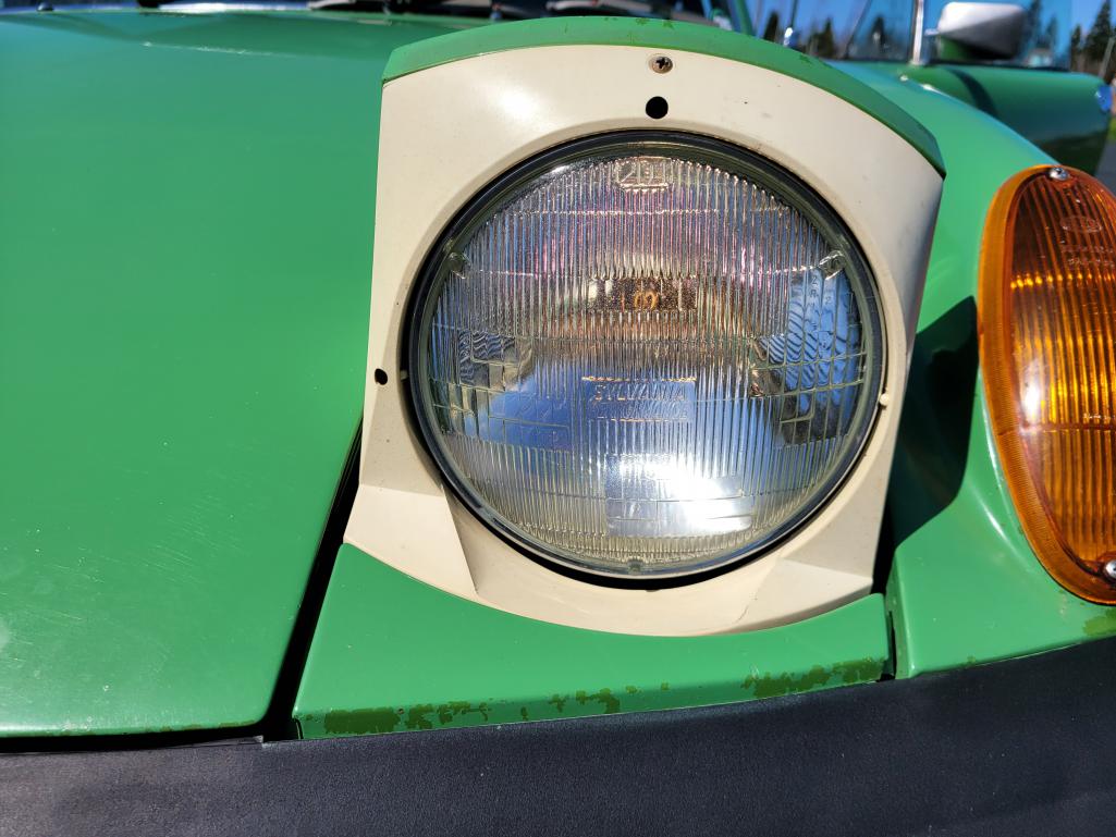

Shivers   Clean and in the sun. 1972   May 23 2023, 09:36 PM
flat4guy   Clean and in the sun. 1972 What was your proc...   Jun 1 2023, 08:17 PM
Jett   Clean and in the sun. 1972 What was your pro...   Jun 2 2023, 08:13 AM
Shivers   Clean and in the sun. 1972 What was your pro...   Jun 12 2023, 10:11 AM
