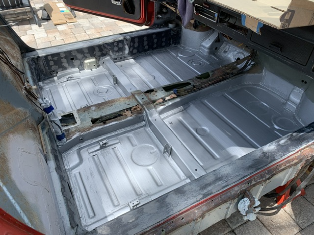

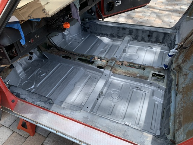

Been a while for an update… floors are done. At least the inside of the floors. Brushed on three layers of rust bullet. Two coats then seam sealed and then the final third coat. I’m impressed with its durability.
Had to treat the longs with ospho for some surface rust that developed during the very rainy week we had here. Will get them cleaned off and coat with rust bullet to finish off the longs and interior floors.
Then I will need to clean and treat the underneath outside of the floors. Followed by Raptor? Herculiner? Anyone want to share their experiences with either?
Thanks for looking.
