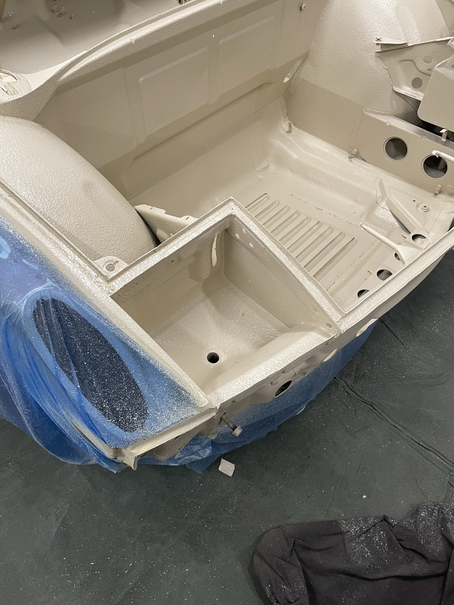

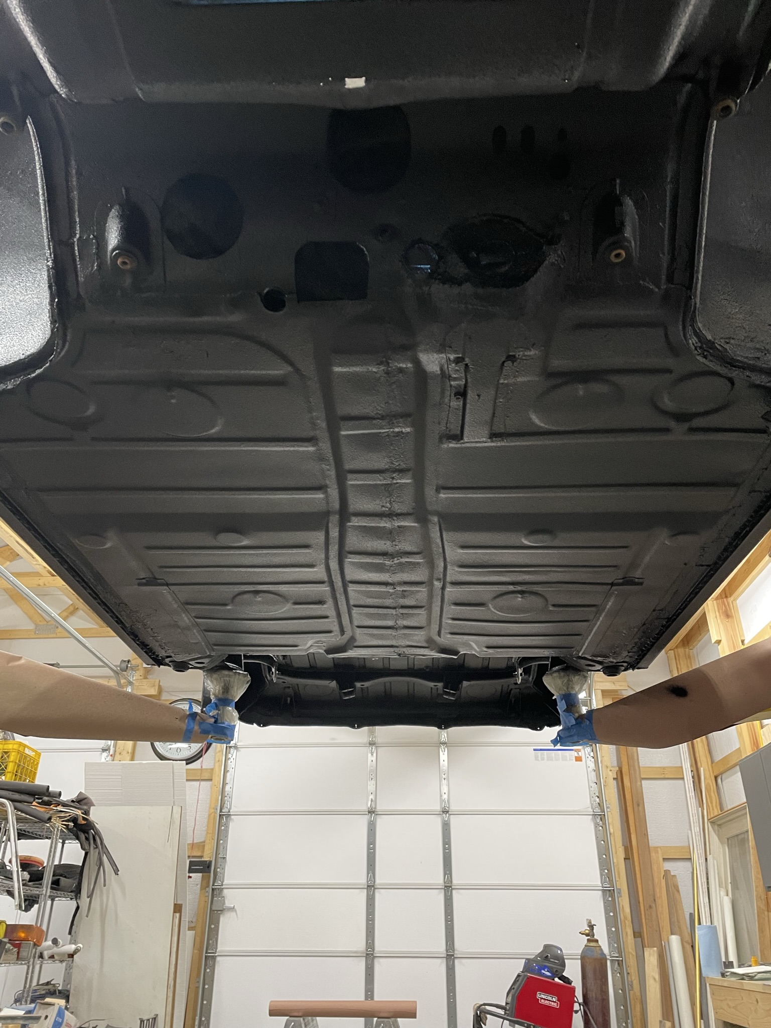

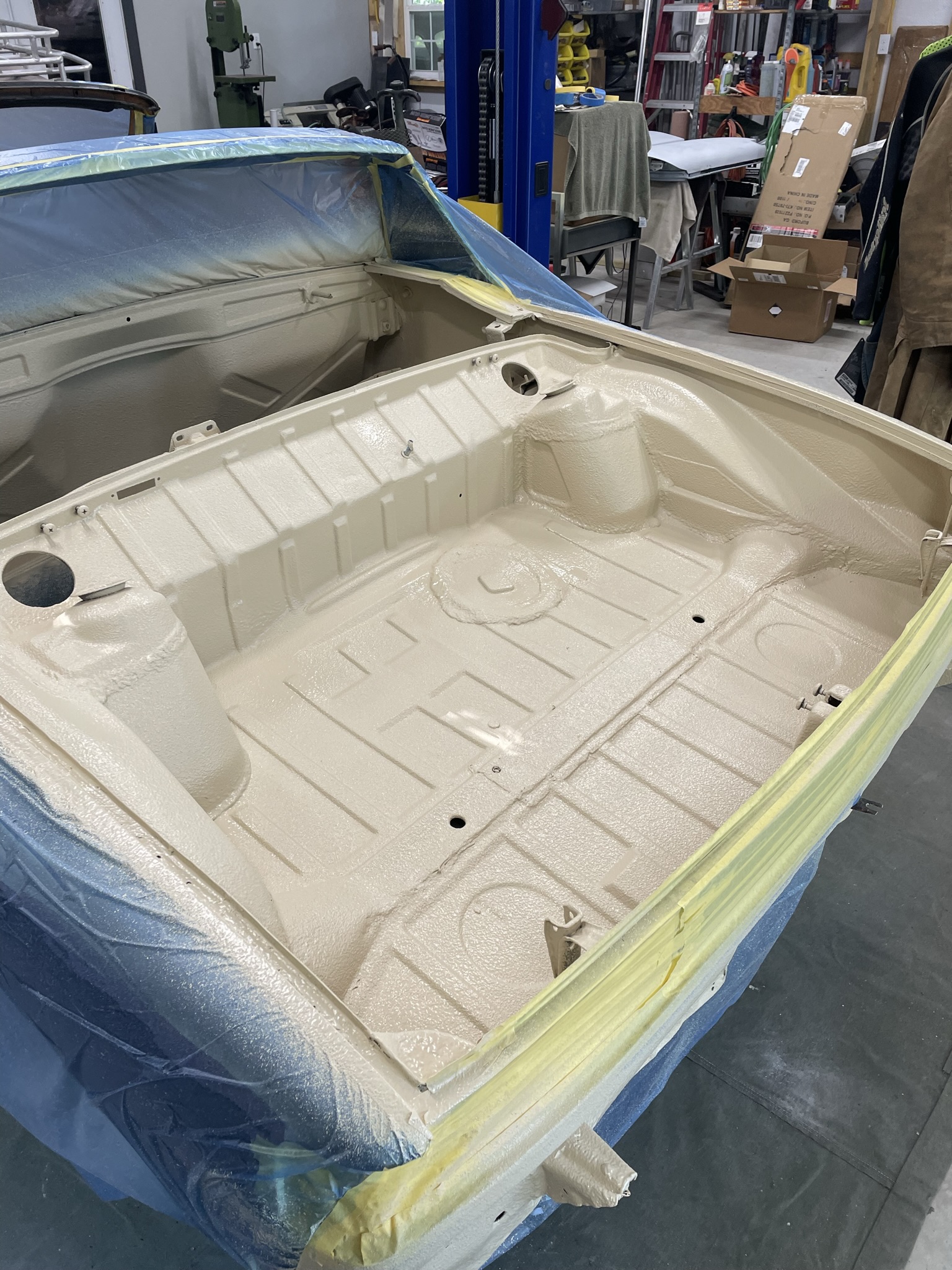

seanpaulmc   Been a while for an update… floors are done. At...   May 27 2023, 05:20 PM
mgarrison   Been a while for an update… floors are done. A...   May 27 2023, 07:20 PM
Dave_Darling   Herculiner? Make sure you don't get it on you...   May 27 2023, 05:41 PM
East coaster   Just sprayed my tub with Custom Coat bedliner (fro...   May 28 2023, 05:18 AM
seanpaulmc   Thanks for the references on the bed / raptor line...   May 28 2023, 09:12 AM
