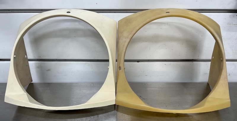

I don't know if this will be of interest to anyone, but there must have been a few different vendors for these. After many hours of stripping with acetone and soaking in a bleach solution, there is where we are left. These are clearly different materials. The one on the right is semi-opaque. Neither has a Porsche part number on them. Neither has any texture. I am guessing they are old, but aftermarket. I thought I was restoring something original, but may end up painting them after all.

Dennis be carefully with acetone,used sparingly it fine but it can cause plastic to go brittle or melt.
IMO a good colour would be VW Alpine white code L90E ,a lacquer and you could get it mixed into a spray can ,seen it mixed and its bright white with yellow and black tinters should be spot on.
I would apply a primer suited for over plastic just to be correct for maximum adhesion.
See how you go,cheers.
