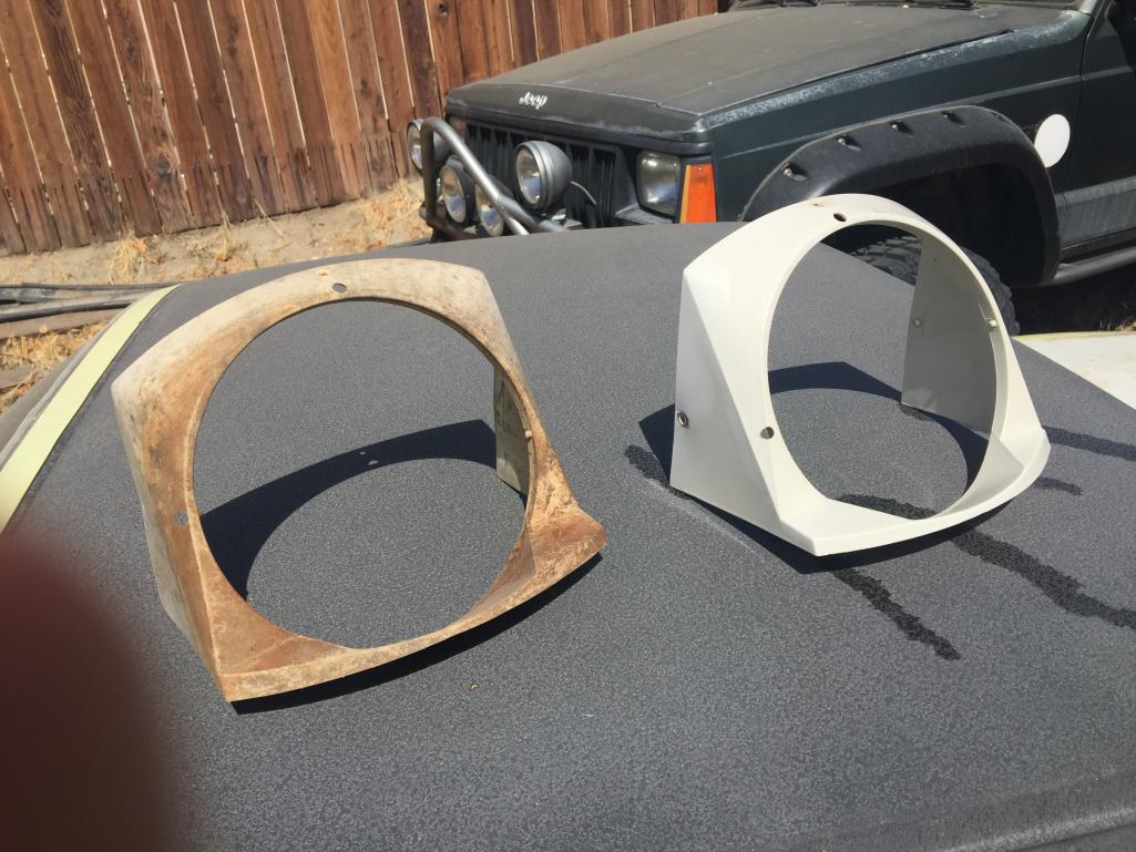

post May 23 2023, 09:36 PM
Posts: 3,335
Joined: 19-October 20
From: La Quinta, CA
Member No.: 24,781
Clean and in the sun. 1972

QUOTE(Shivers @ May 23 2023, 08:36 PM) *
What was your process? Going to try easy off this weekend for starters.

QUOTE(flat4guy @ Jun 1 2023, 07:17 PM) *
Like others said it was a bleach / water bath for a week and simple green after. I didn’t
use anything abrasive.
