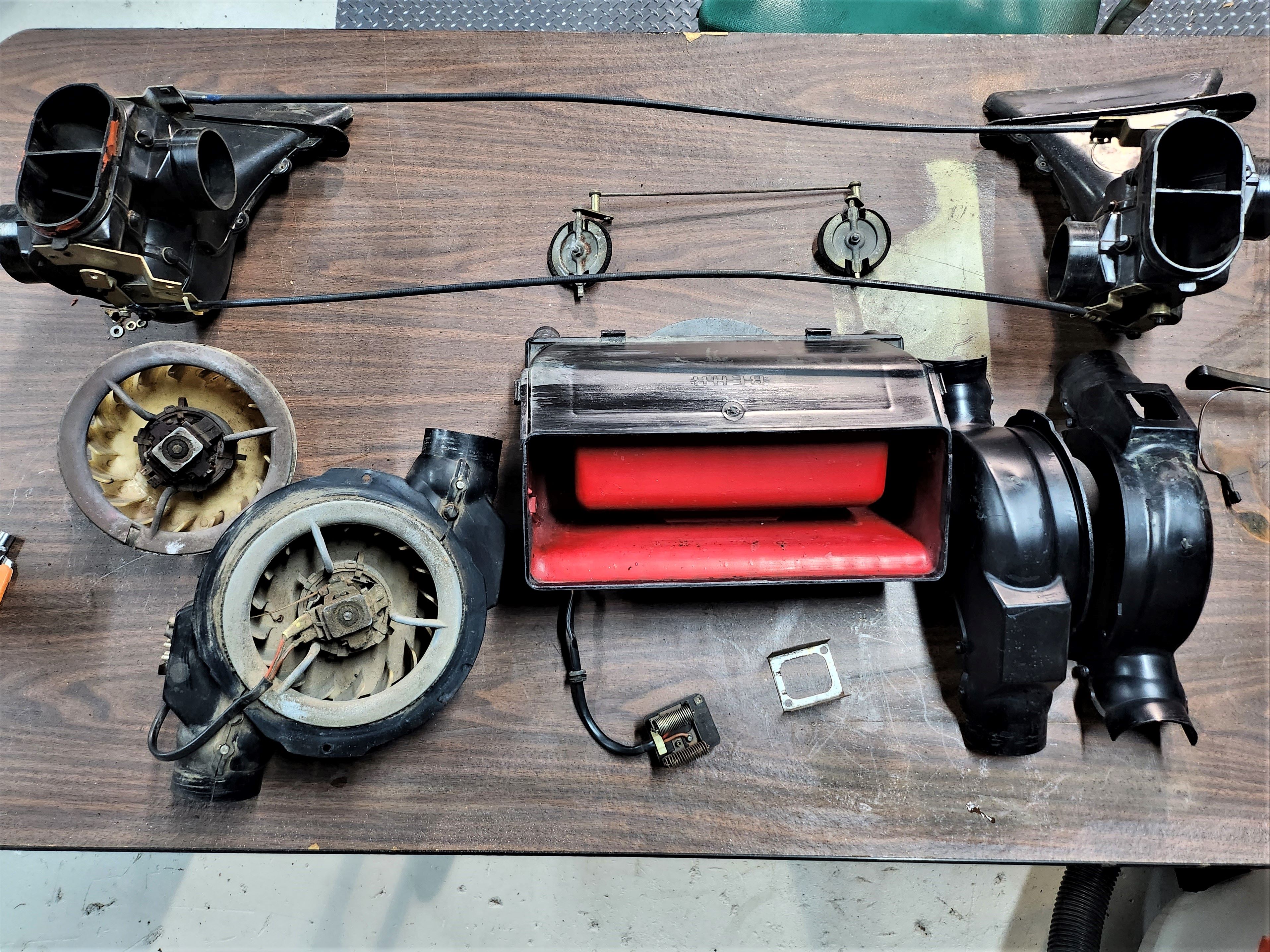

Not digging the fresh air / defrost job at all. I have two complete sets in the stash, and MAYBE half is usable because of cracks and broken tabs. The good airbox has overspray that won't come off, so semi-gloss black rattlecan is gonna happen.
At least the blower motor is available.
