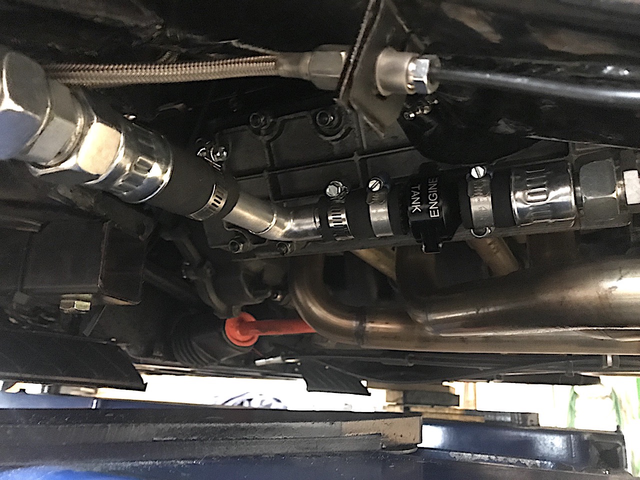

Hi Pete. I fabricated a 90 deg fitting for the oil line so it would not kink when using the oil drain back device. If I make another one I will incorporate a drain plug in it. Best, MarkAttached Image

peteinjp   So you just cut the stock hose to make that correc...   Jun 14 2023, 05:41 AM
