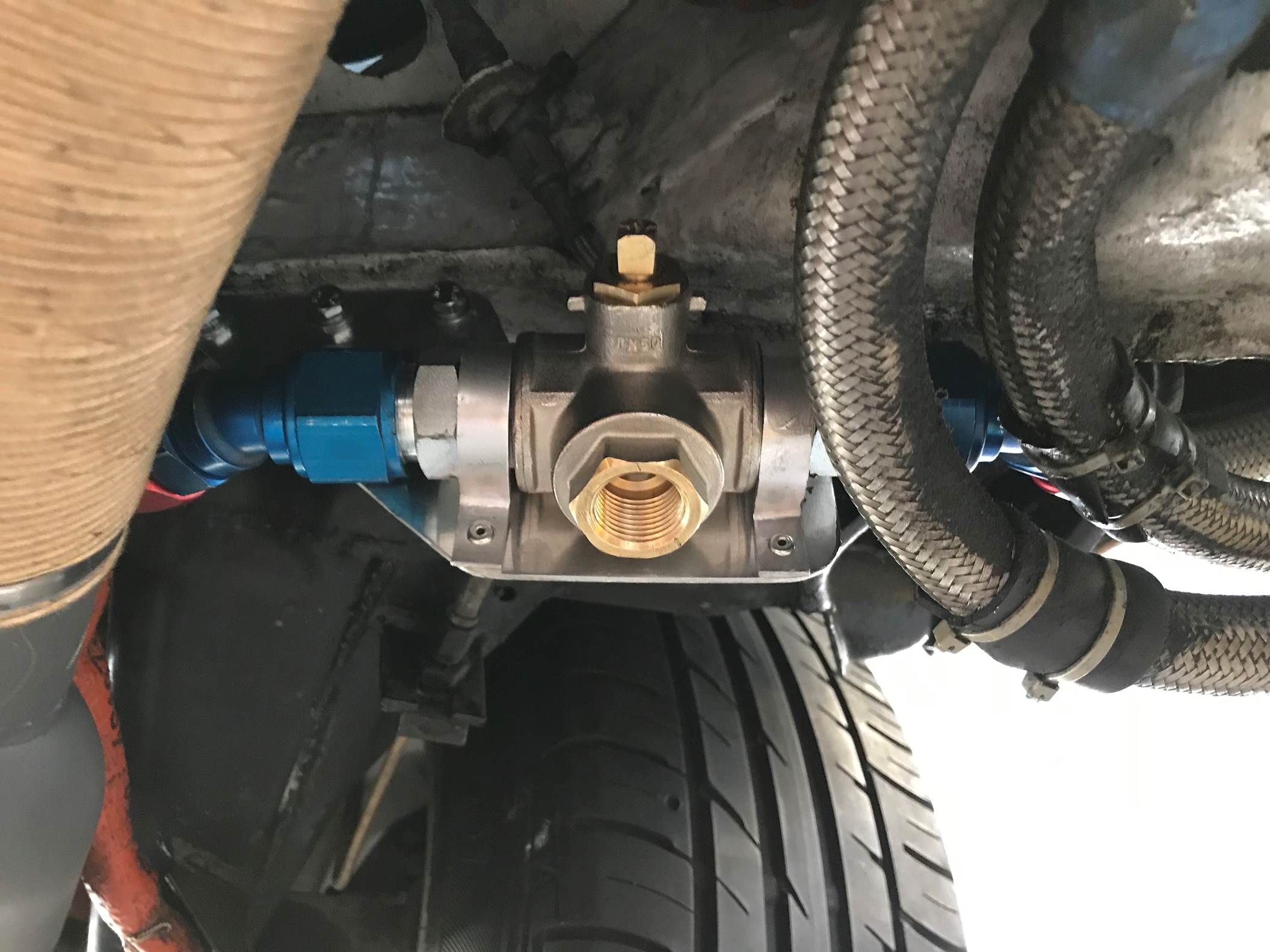

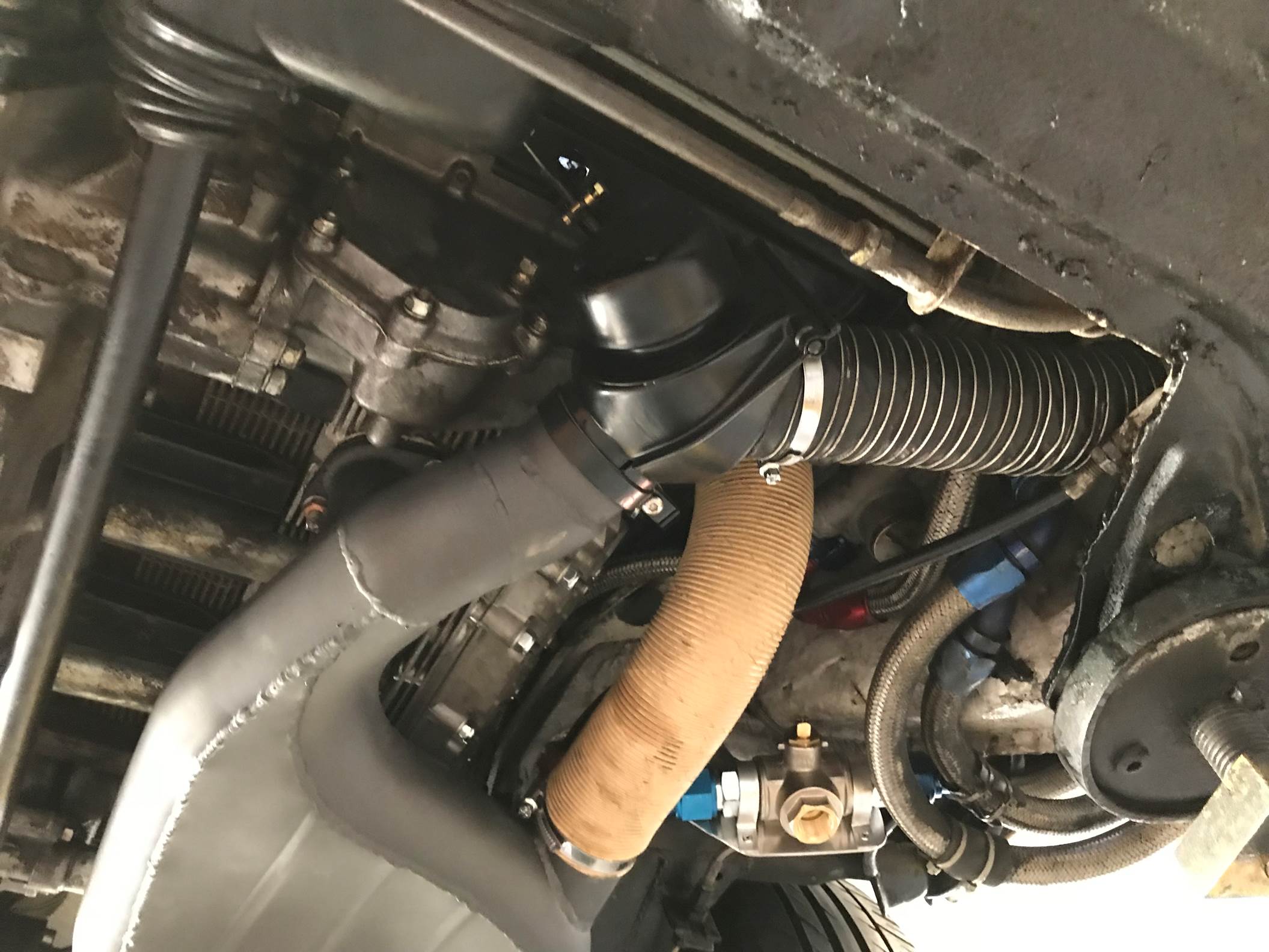

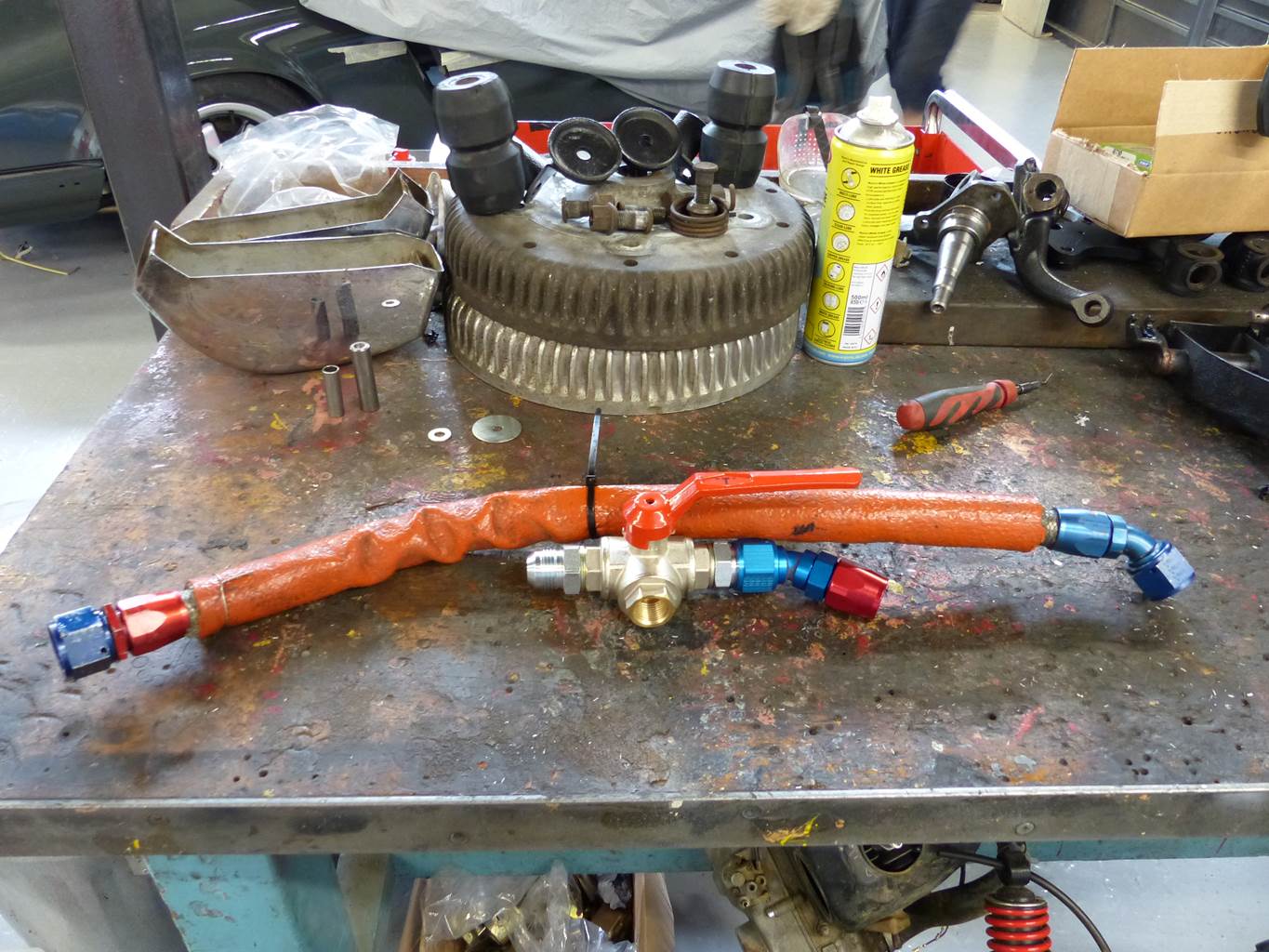

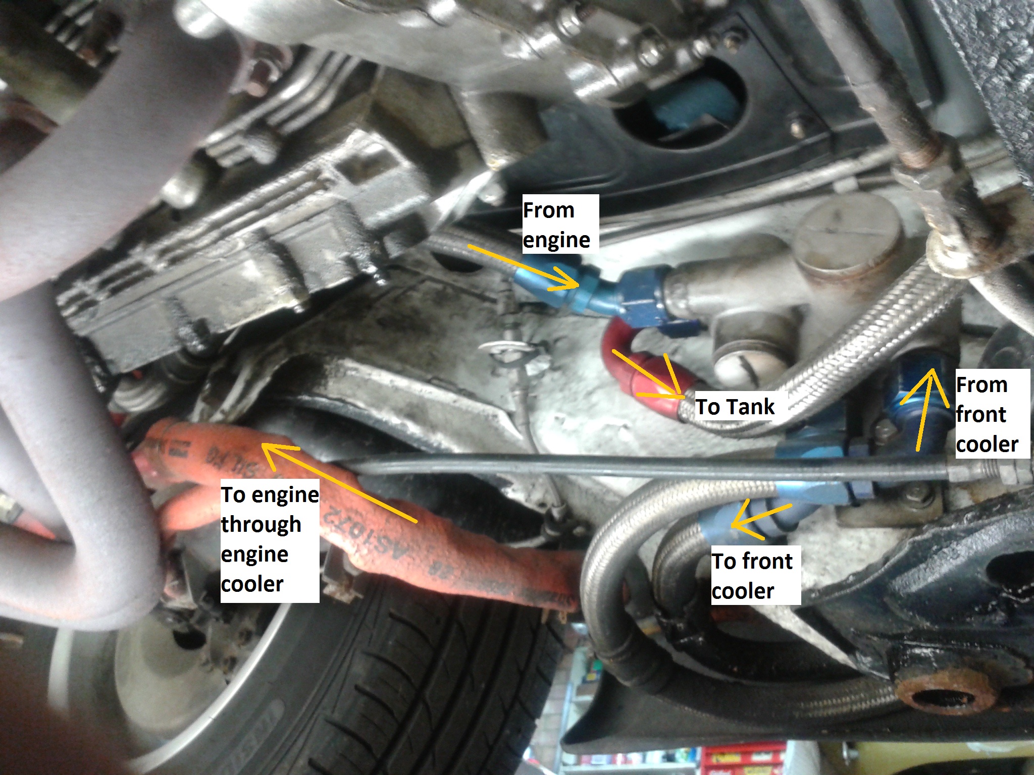

Definitely recommend doing this in terms of the time saving and preventing the risk of putting any stress on the weld to the engine oil coller in removing the pipes (which was my previous experience).
Mine's a 3.2 with a termostat to the front cooler, but pics show the old set up (with annotations) and new set up with the 3 way ball valve installed (threaded brass plug to the drain hole is not shown as fitted in photo but obv. should be) on the line to the engine cooler. Only issue too with a front oil cooler, as per this set up, is that you can never fully drain the system towards the front, not an issue with regular oil changes.
