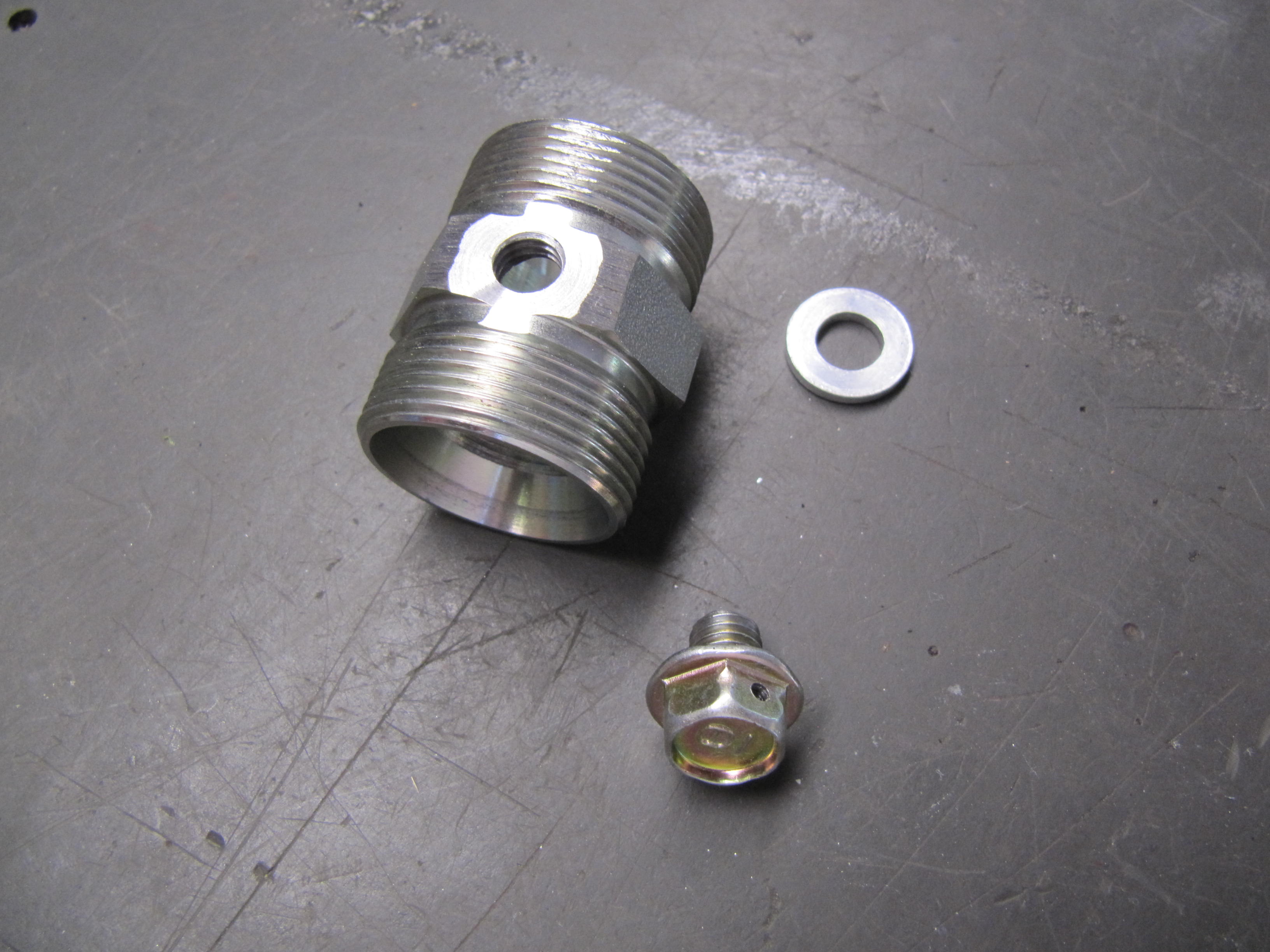

Its not a huge deal to separate the hoses but if changing the oil often it would be nice to plumb in a valve or some type of plug to reduce long term wear on the hose seal. Anyone done this? Or any other thoughts?

I put it on the union for the two oil lines. It works very well and was easy to do. OEM lines and tank on a conversion car.
I had a machinist drill hole and face the surface so it was flat.

QUOTE(Krieger @ Jun 14 2023, 08:28 AM) *
I really like that! Running stock 914-6 lines and will do the same. Neat idea!
