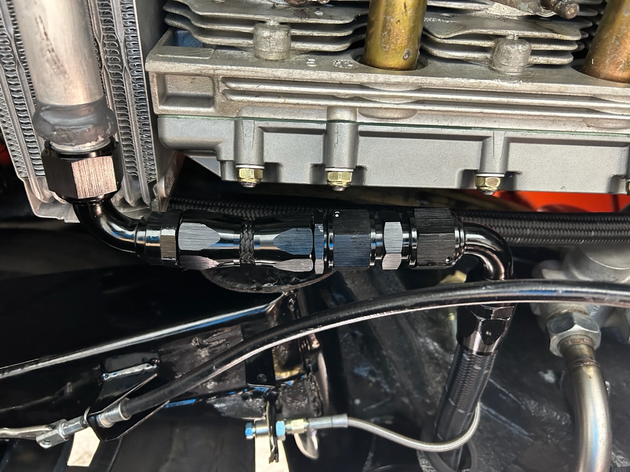

Its not a huge deal to separate the hoses but if changing the oil often it would be nice to plumb in a valve or some type of plug to reduce long term wear on the hose seal. Anyone done this? Or any other thoughts?

Can you imagine how long it would take to drain the tank though without disconnecting the hoses? It would be painful. I use -12 on my feed lines with a union and remove one line. I am not sure on the drain at this point. Attached Image
