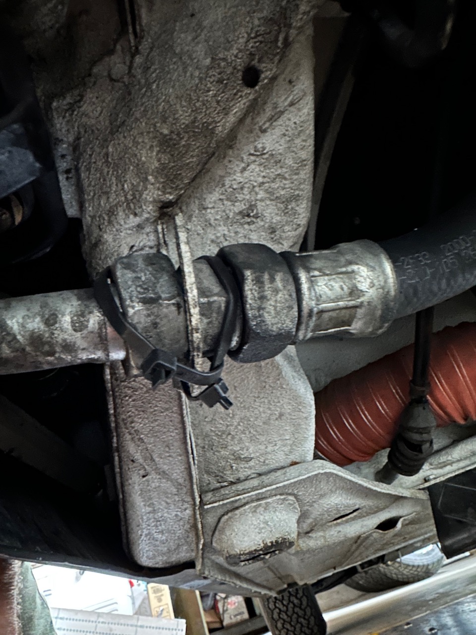

How hard was it to get KED clocked? In may case I might need to find a different way to hang the hoses as the dump would be in the support hole.
Man that sounds even more wrong...
I haven't noticed this support on any other cars. Was it added to mine or??

QUOTE(peteinjp @ Jun 14 2023, 11:06 PM) *
The hanger was/is on the factory sixes. There should be a large rubber grommet around the oil line that sits in the hanger. Open near the top to allow the hose to be removed as I don't think it was large enough for the factory fittings to slide thru.
I think I have some pictures around somewhere.
Tie wraps are aftermarket...
