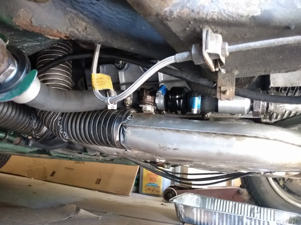

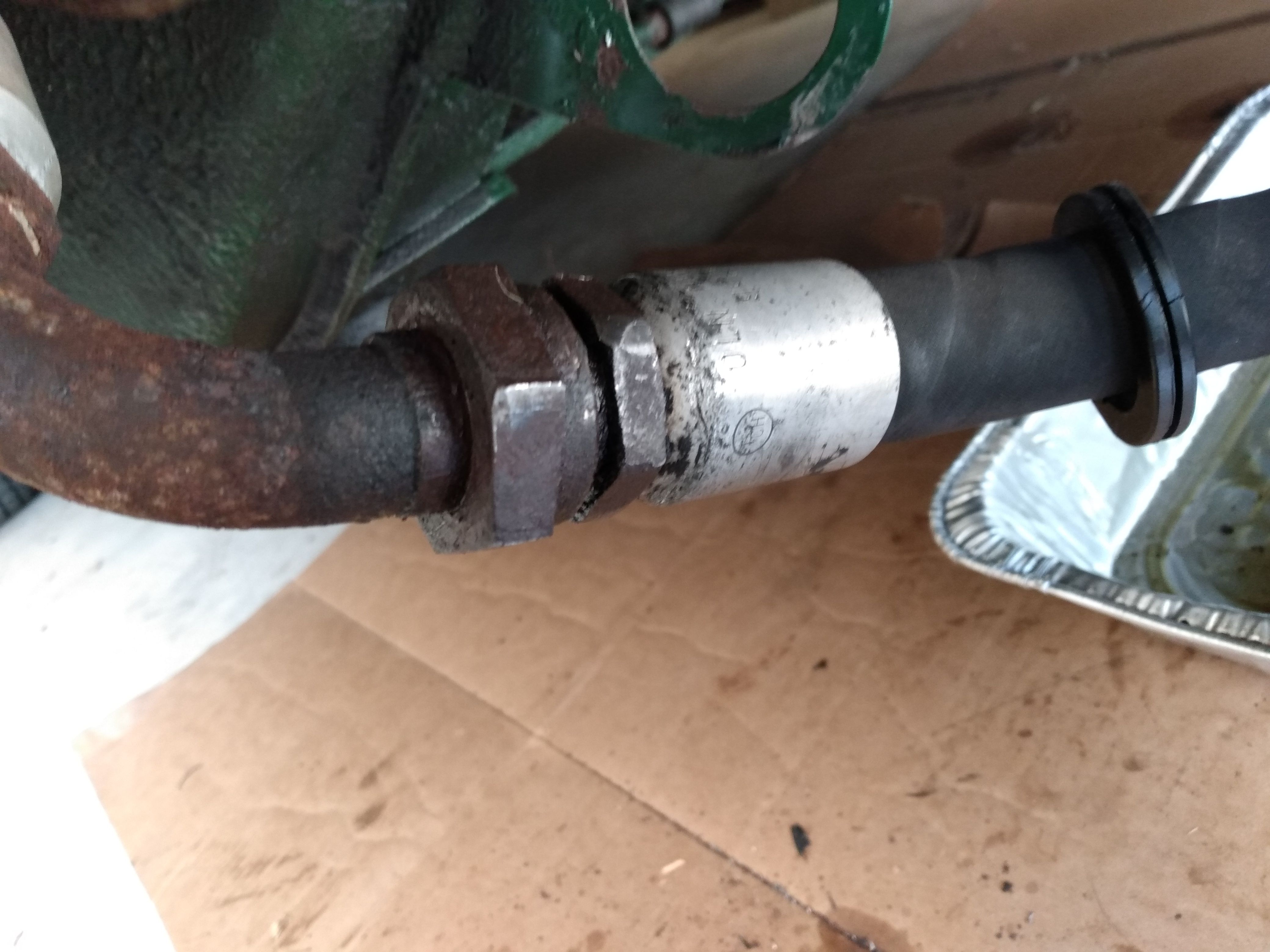

Here's a picture showing the hook and the rubber grommet. It fits around the metal end of the factory hose. Second picture is with the Rothsport valve installed
