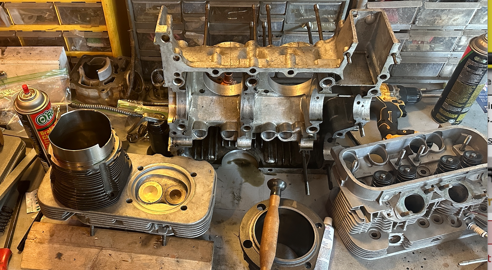

Just got a new tube of valve lapping paste...The old one lasted 45 years!
Tonight lapped the cylinders to the heads(no head gaskets). I did not lap last time but did have the heads fly cut each time to true.
The new intakes were recut (machine not stone) and new guides. Owner of the shop said. These will be much better than the old valve jobs. They lapped the intake , so I decide to lap the exhaust too. Look good.
I ran a thread die on all the case studs and pullout all the plugs to clean with a gun cleaning kit prior to final cleaning . Lots of cleaning , then lots more
