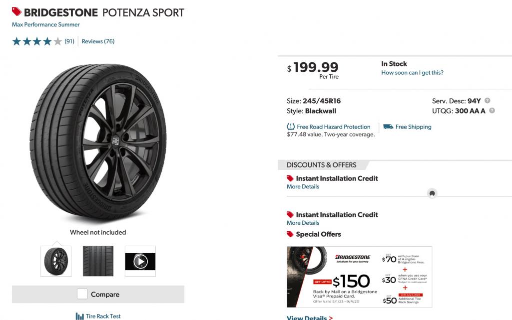

burton73
post Jun 22 2023, 12:26 PM
Senior member, and old dude
Posts: 4,103
Joined: 2-January 07
From: Los Angeles
Member No.: 7,414
QUOTE(bigkensteele @ Feb 5 2013, 07:43 PM) *
QUOTE(ClayPerrine @ Feb 4 2013, 10:04 AM) *
Just a thought on the 8s.
The only company making 245/45-16 tires is Bridgestone. They make them in the RE8 line, and they are about $500.00 a tire, and you will have a bitch of a time getting Discount tire to even admit that they are available. I had to find them online, and take the printout down to Discount tire. Even then the manager had to fight with the Bridgestone ordering department, because they couldn't find them in the catalog. Then I had to wait almost a month because they are a limited production run and were back-ordered.
Thanks, Clay, ClayPerrine@ but I think that 245s would be out of the question on a narrow body. I didn't think that 8" rims would be possible until I found the pics of Harold's car.
After reading all of the much appreciated responses, I believe that I am going to give the 8s a try in the back with 205/55s. I know that I am going to have to do some pulling/rolling, but if it looks do-able, why not? If the 8"s don't work, I will put 911 7"s on the rear and the 951 7"s up front.
When/if I decide to put the flares on, I will use the 951 8"s on the rear and probably the 911 7"s on the front.
Of course, I still need to actually do the 5 bolt conversion, for which the parts have been sitting on my shelves for quite a while. (IMG:style_emoticons/default/wacko.gif)
Clay, looks like you can now in 2023 get a number of tires in 245/45 16 at not to much money
