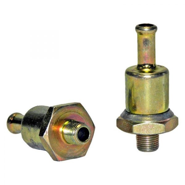

I take the brass inlet fitting on the airtex e-8445 and remove the nipple, then fit it with this:
That is a fuel filter for a carbureted Ford.
The inlet on this is the same size as the suction port on the tank, and it is a filter to protect the pump from crap in the tank.
