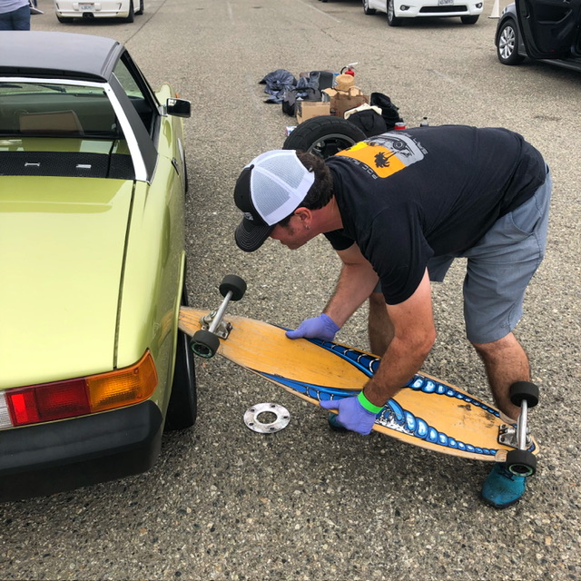

A7s are wider than A6s were. Even with some pull, we still have a light rub on the inside and outside, need more of a pull but Aaron keeps thinking he will put on Gt flares one day. Fortunately for me he isn’t overly sentimental about the paint job he spent 3 years on.
