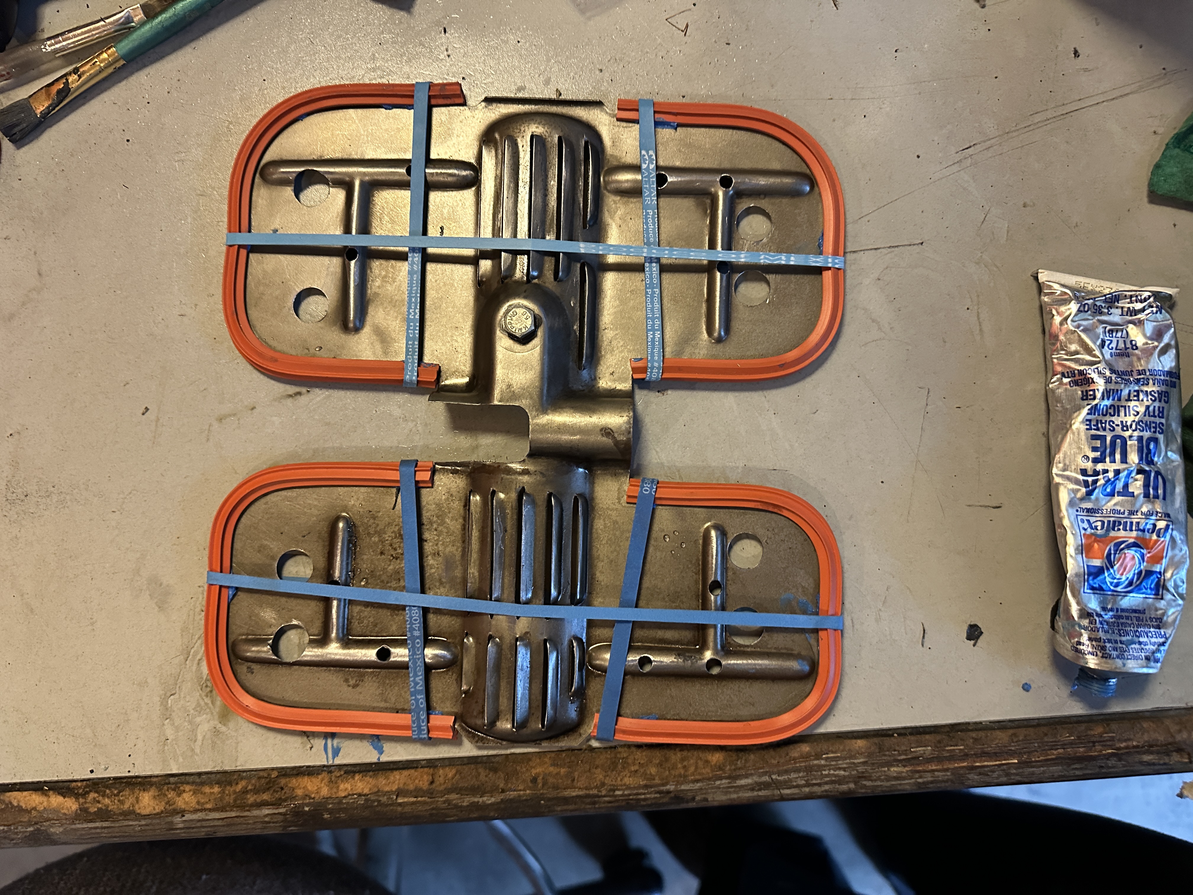

The windage tray had the same old seals, so a new set glued in place and ready for installation along with the cam bearings. USING A DOUBLE THRUST and setting the endplay at .002 inch flipping the bearing without out the tab 180 degree got my play set about right. The 2 shells work working against each other and canceling out he endplay important to test the play on both half and Assembly to ensure you have it just right

rfinegan   The windage tray had the same old seals, so a new ...   Jul 9 2023, 03:56 PM
