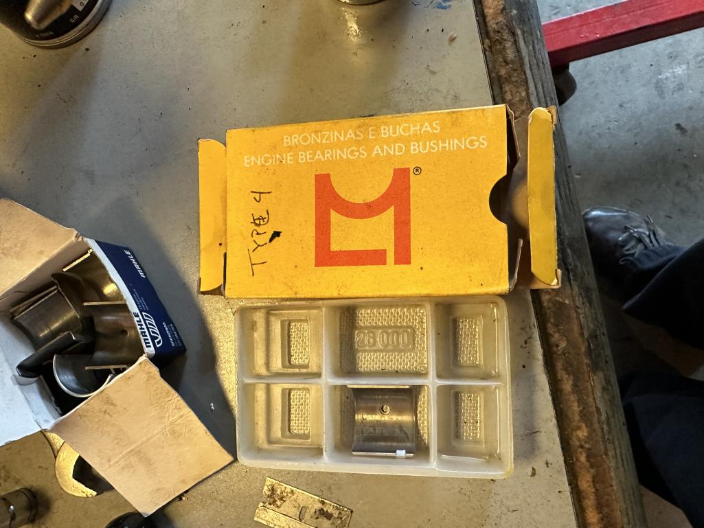

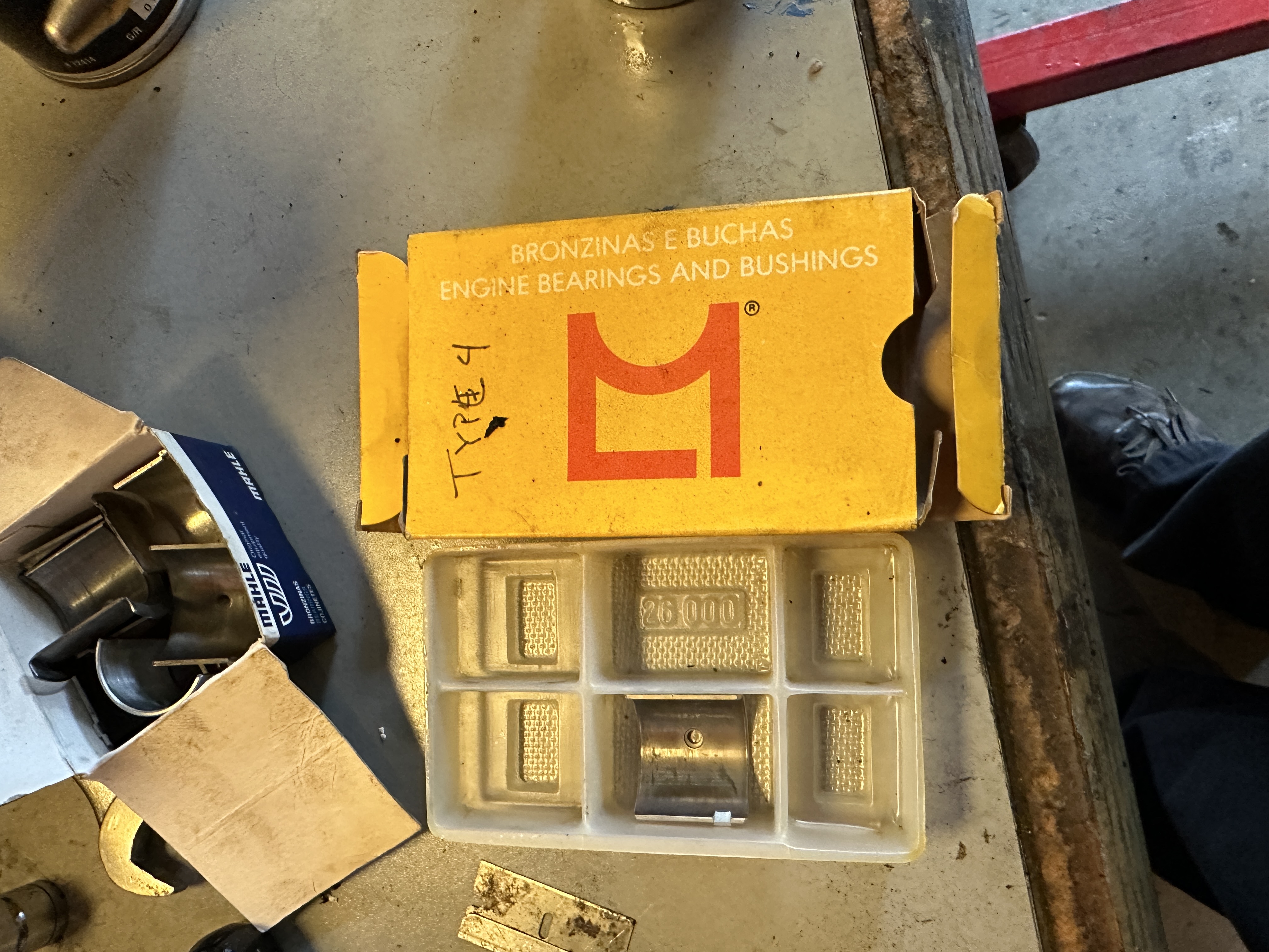

rfinegan   I may be CRAZY, but got a set of ML Cam bearings n...   Apr 7 2023, 11:06 AM
rfinegan   NEW KS 2.0 rod bearing are HERE....   Apr 7 2023, 11:07 AM
