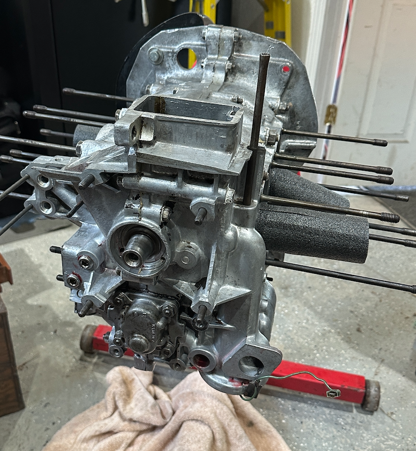

Measured the case, bearings and crank journals as well as plastic gage the split shells.
Case is sealed and about ready to jugs and slugs...Attached Image
