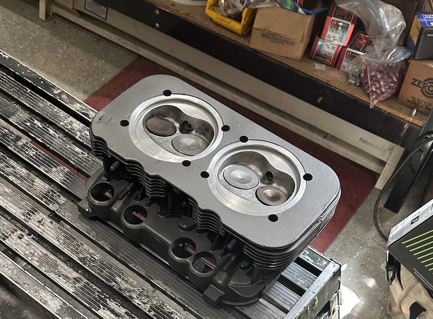

rfinegan   Playing with a thermal dispersion paint from Cerak...   Jul 17 2023, 05:30 AM
rfinegan   heads   Jul 17 2023, 06:14 AM
