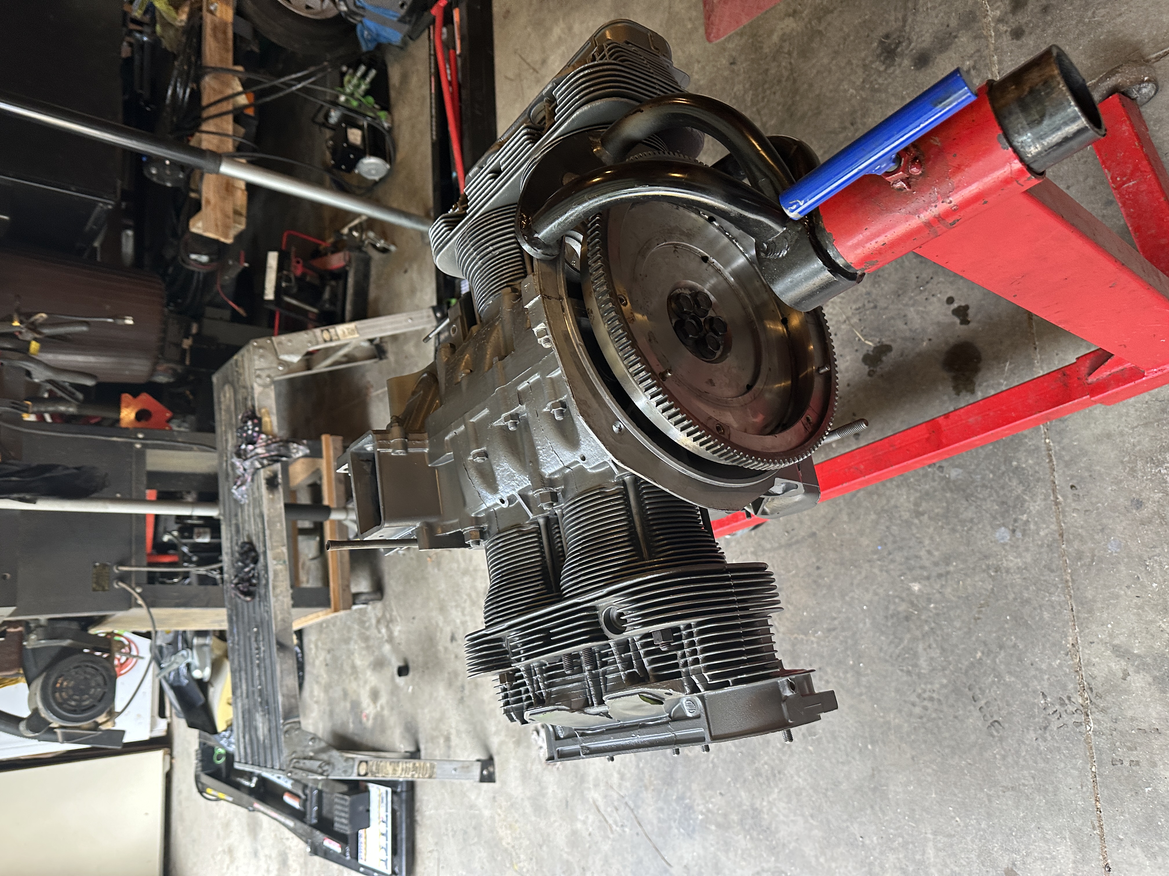

Tonight I cleaned the carbon off the piston tops and got everything ready to install
Piston rings lubed and skirts and pins and started assemble .
Problem:
The new engine yoke did not have enough room to install piston pin # 3. #4 is installed first on the right side because the oil cooler is there and the pin is installed from the rear/center of the motor. When I got to # 3 the pin would not clear the engine yoke and I had to set it down and remove the yoke and install the pin/cylinder assembly. 10 extra minutes so not be deal .
Starting to look pretty good....
