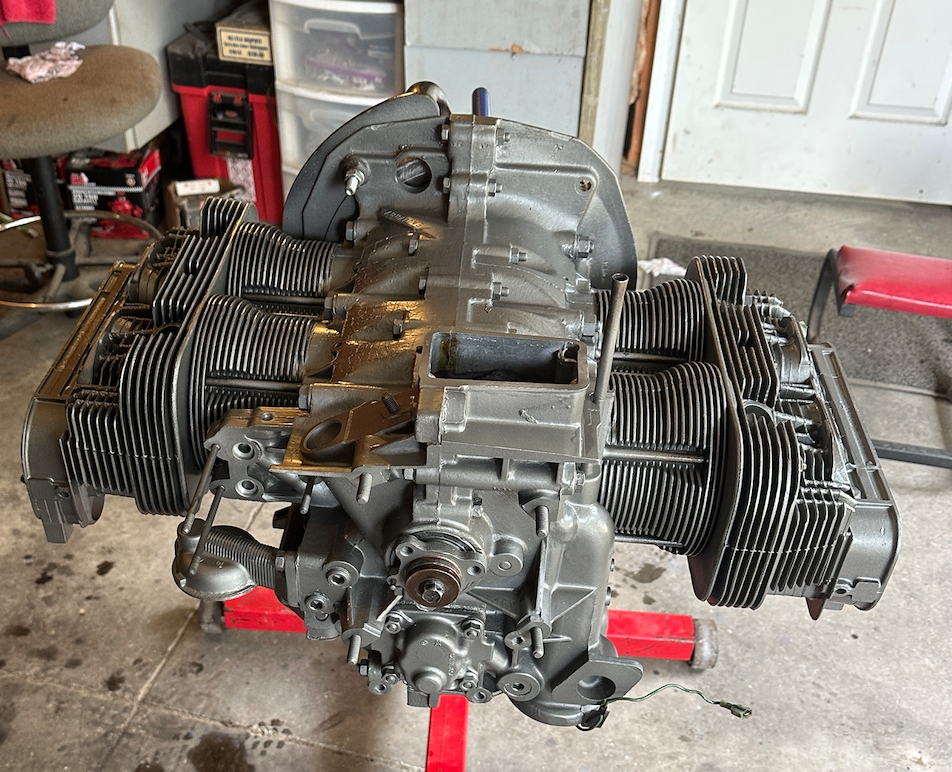

rfinegan   Tonight I cleaned the carbon off the piston tops a...   Jul 19 2023, 04:28 PM
rfinegan   another   Jul 19 2023, 04:29 PM
rfinegan   one more   Jul 19 2023, 04:29 PM
