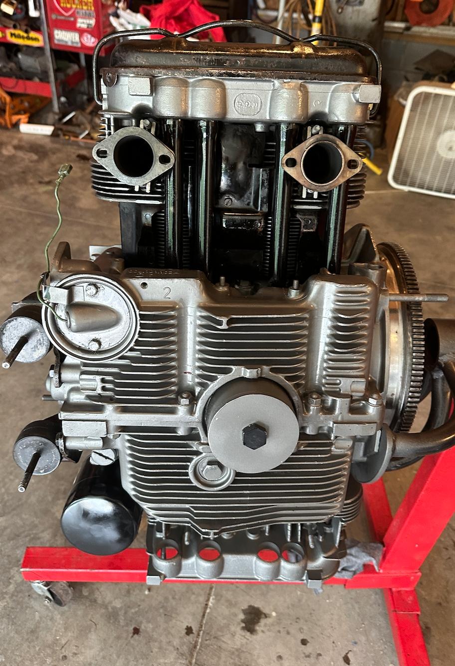

Darn, the engine yoke got me again. its touching the # 3 cylinder. I need to pull it off again and make a slight grinder modification to the mount so it now longer touches and I can torque the head.
However i did make good progress and I have another day to get back on track... I get a pic later to show how I did this.

rfinegan   Darn, the engine yoke got me again. its touching t...   Jul 23 2023, 07:30 AM
rfinegan   DIY: Jet Doctor for idle jets or just by them fro...   Jul 23 2023, 11:11 AM
rfinegan   oil primer in progress...   Jul 23 2023, 02:30 PM
rfinegan   engine update..stubs and tins next...   Jul 23 2023, 02:34 PM
rfinegan   engine yoke mod...#3 cylinder   Jul 23 2023, 02:36 PM
rfinegan   cylinders hitting the the yoke frame   Jul 23 2023, 03:25 PM
