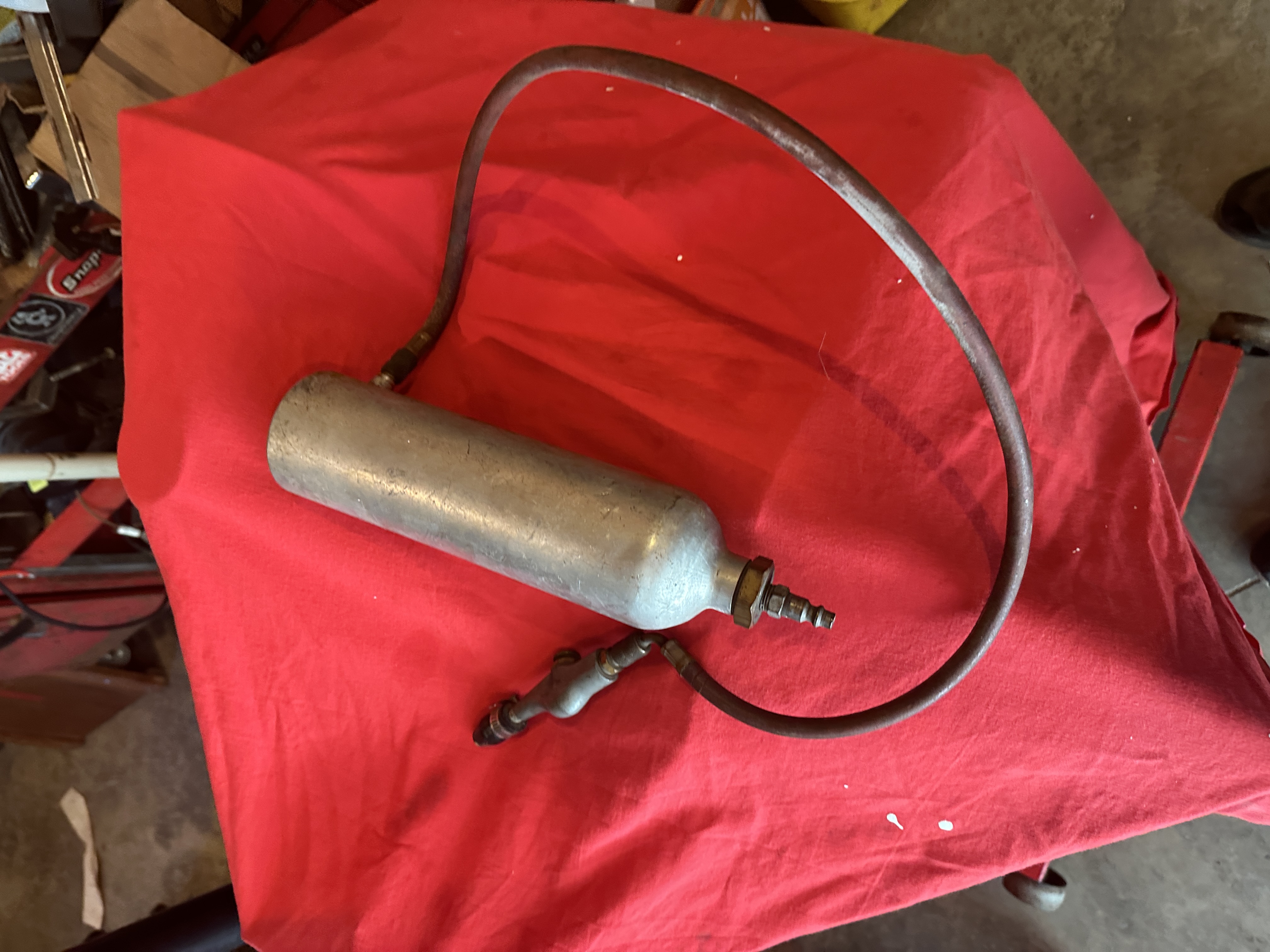

rfinegan   oil primer in progress...   Jul 23 2023, 02:30 PM

rfinegan   Add a PMO fuel regulator (purchased in the classif...   Aug 6 2023, 01:53 PM
