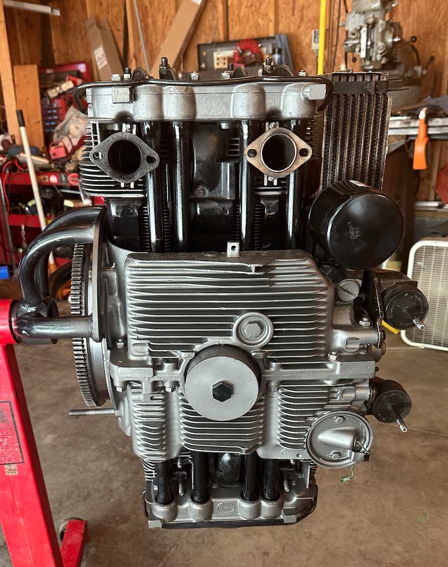

rfinegan   oil primer in progress...   Jul 23 2023, 02:30 PM
rfinegan   engine update..stubs and tins next...   Jul 23 2023, 02:34 PM
rfinegan   engine yoke mod...#3 cylinder   Jul 23 2023, 02:36 PM
rfinegan   cylinders hitting the the yoke frame   Jul 23 2023, 03:25 PM
rfinegan   Today I installer the blower housing, blower front...   Jul 24 2023, 04:24 PM
rfinegan   another pic of the bottom   Jul 24 2023, 04:27 PM
