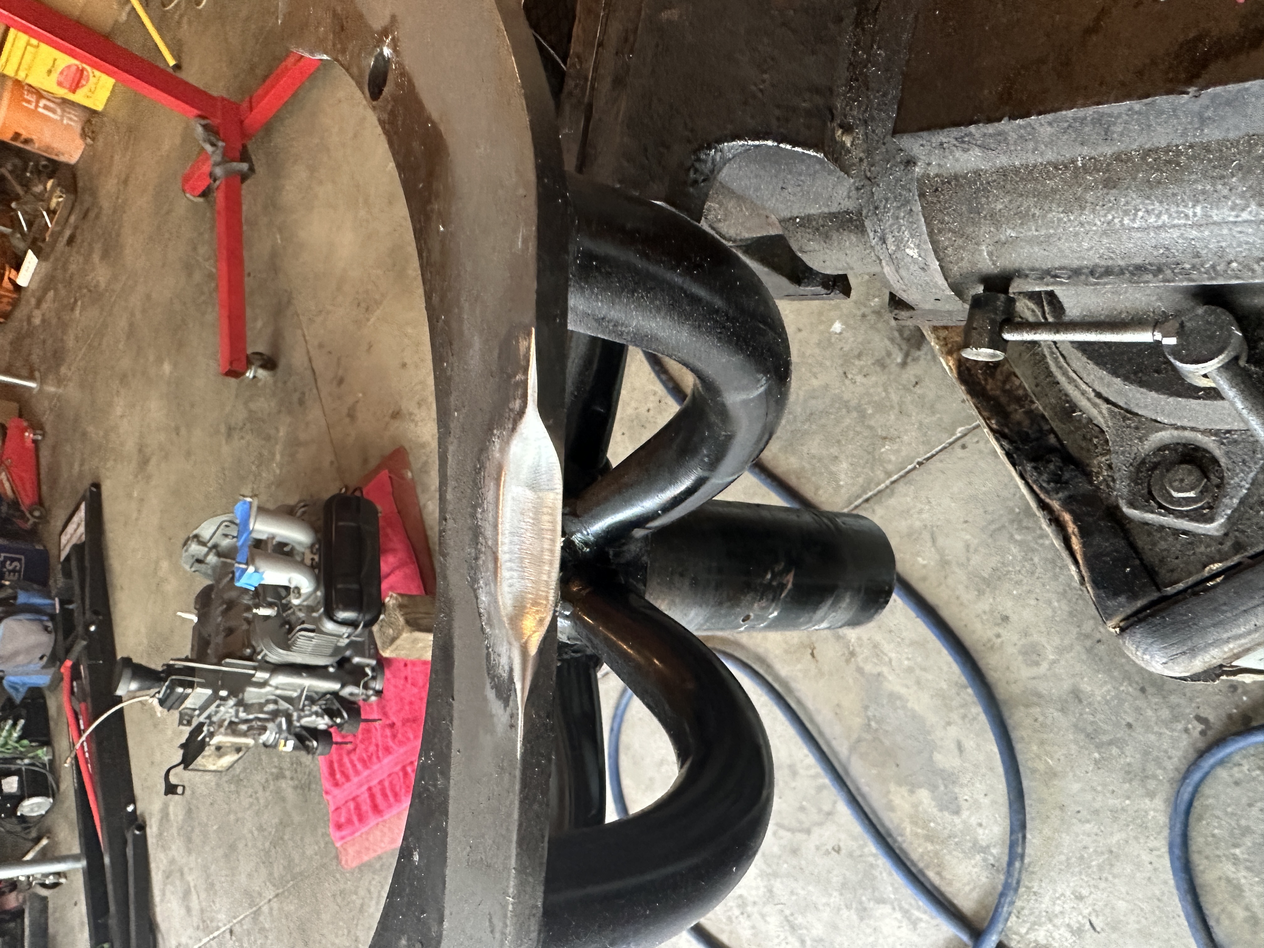

rfinegan   Darn, the engine yoke got me again. its touching t...   Jul 23 2023, 07:30 AM

rfinegan   engine yoke mod...#3 cylinder   Jul 23 2023, 02:36 PM
rfinegan   cylinders hitting the the yoke frame   Jul 23 2023, 03:25 PM
