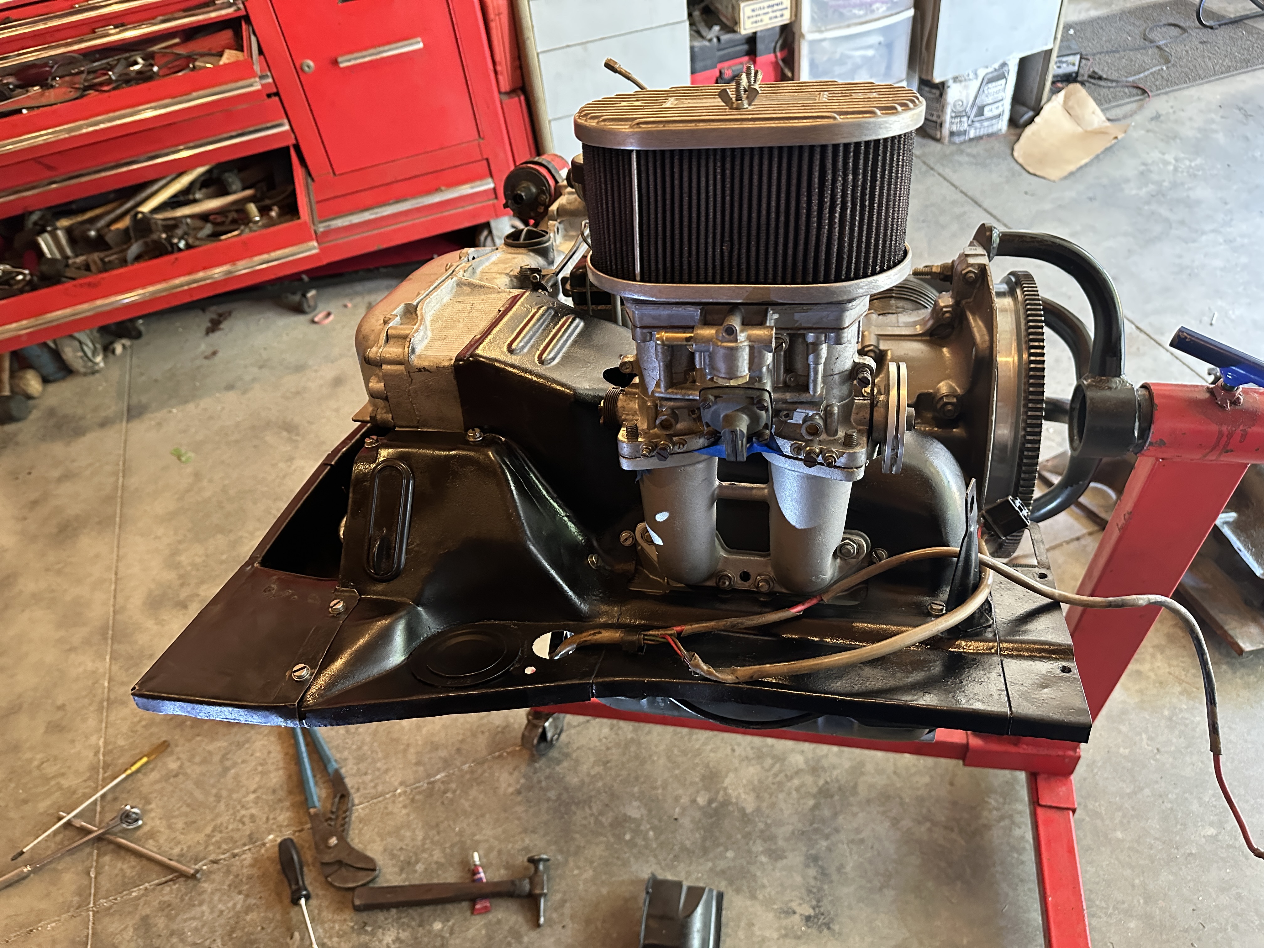

Today I installer the blower housing, blower front tins alternator, belt left tin, intake...
Wanting for a Distributor drive spring before installing the right tin (tues)Attached Image

rfinegan   Today I installer the blower housing, blower front...   Jul 24 2023, 04:24 PM
