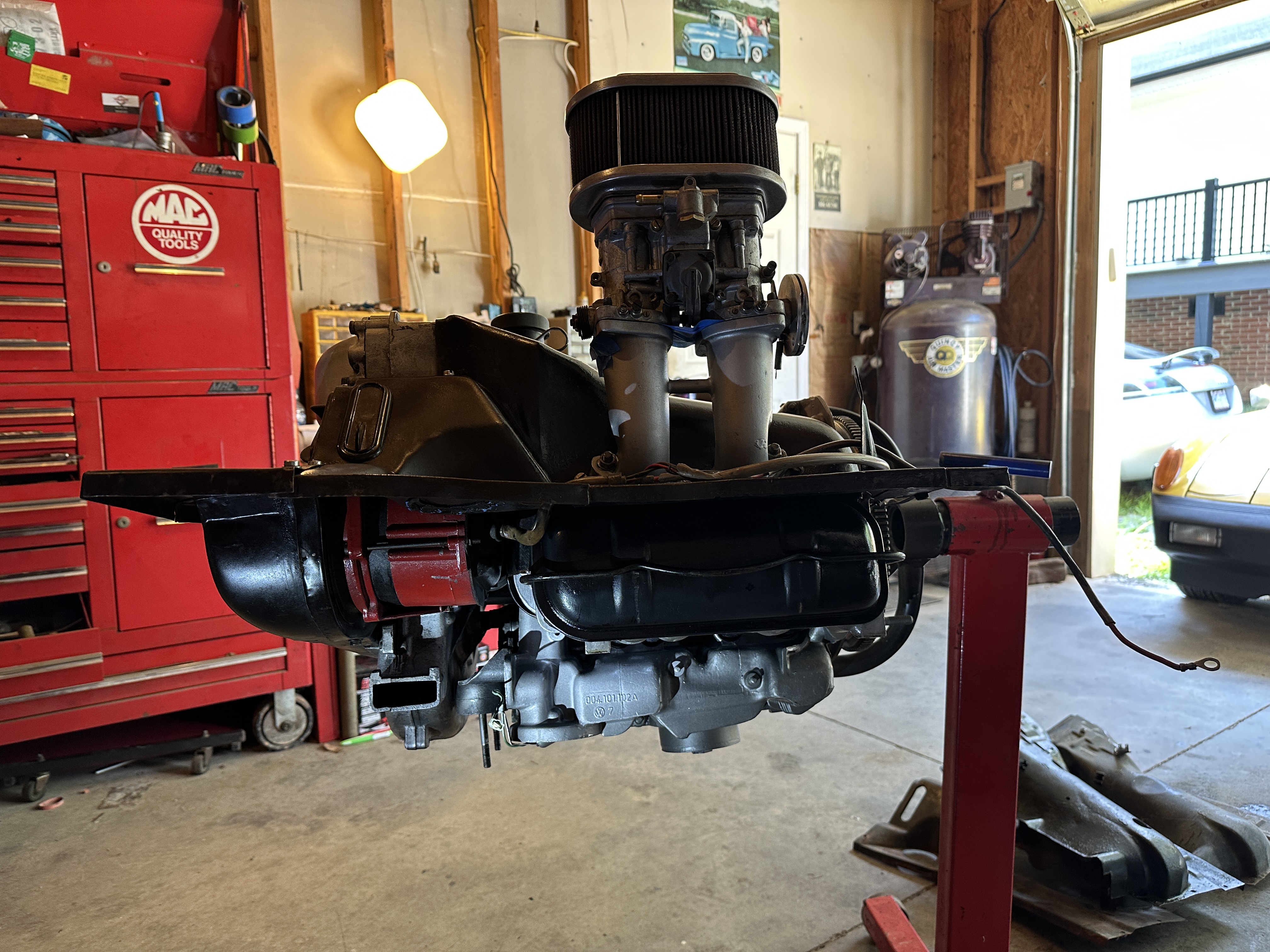

rfinegan   Today I installer the blower housing, blower front...   Jul 24 2023, 04:24 PM
rfinegan   another pic of the bottom   Jul 24 2023, 04:27 PM
porschetub   another pic of the bottom looking great,thermost...   Jul 28 2023, 08:32 PM
