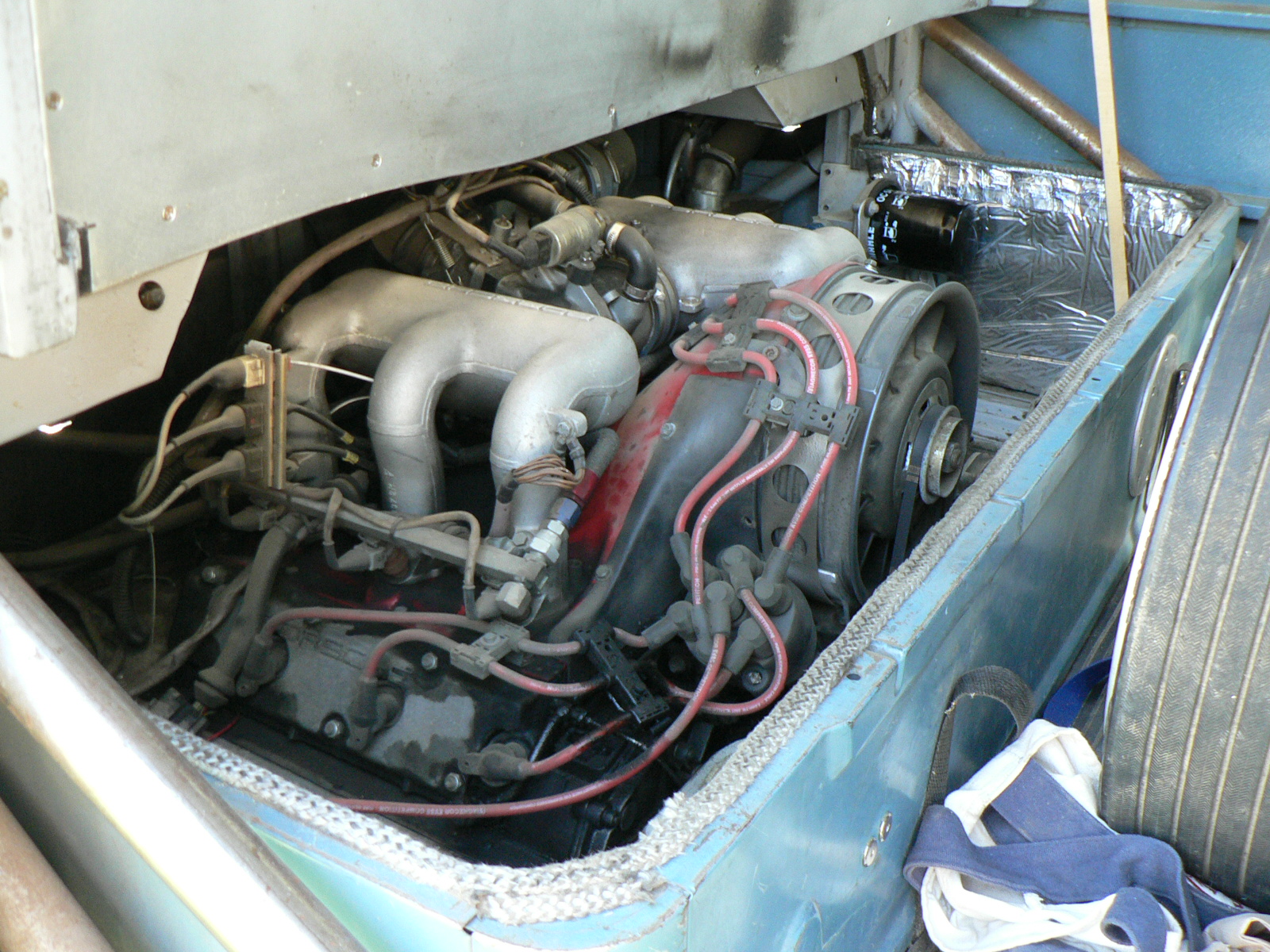

Maltese Falcon   @mepstein Found an MSDS Vanagon ('80-92) 3.2L...   Nov 12 2022, 12:28 PM
Maltese Falcon   Let's go for a ride in the dirt...in the dry-b...   Nov 12 2022, 12:34 PM
Maltese Falcon   Another pic   Nov 12 2022, 05:36 PM
Maltese Falcon   Under the bonnet :D   Nov 12 2022, 05:41 PM
