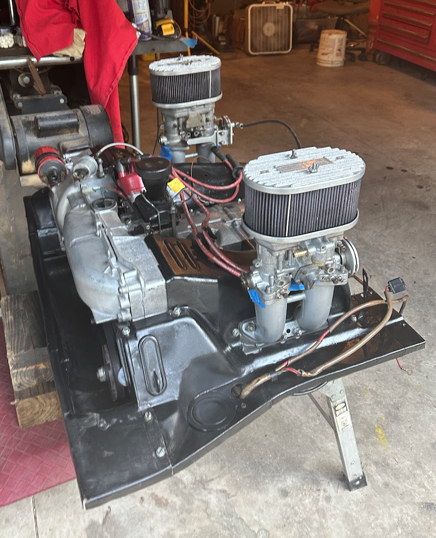

rfinegan   Today I recondition push rod tubs to remove dents ...   Jul 28 2023, 05:48 PM
rfinegan   added right tins and distributor   Jul 28 2023, 05:52 PM
barefoot   added right tins and distributor Make sure yo...   Jul 29 2023, 06:54 AM
rfinegan   I may have to try to fit an aftermarket thermostat...   Jul 29 2023, 06:38 AM
rfinegan   Good eye. Not wanting to pull the alternator/cover...   Jul 31 2023, 05:45 AM
