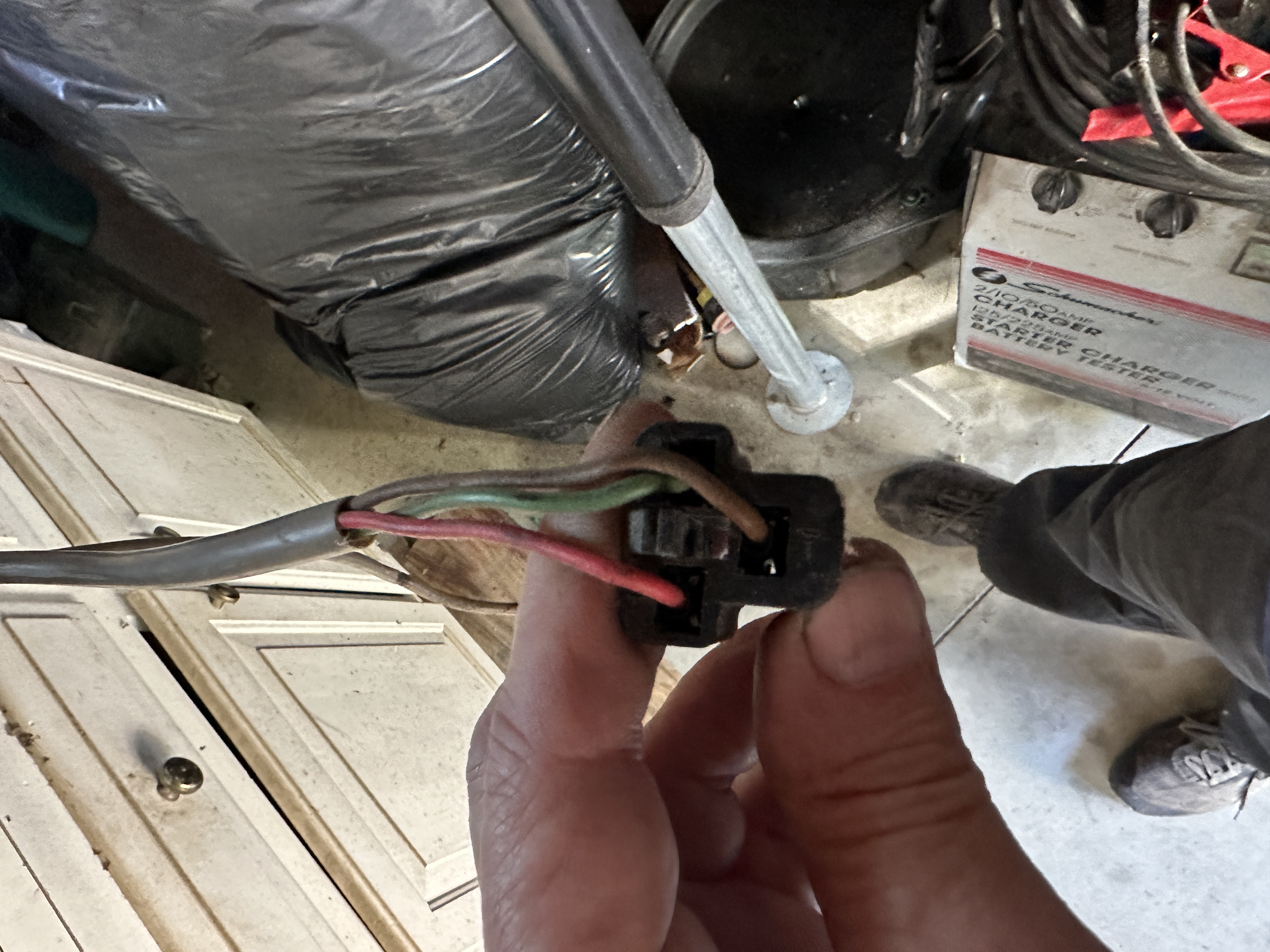

Good eye. Not wanting to pull the alternator/cover I have been putting this off. I decided now with your comment, to pull the terminals our of the connector and install a seal/bushing. It was not as painful as it sounds with a terminal too. Seal from Hot air and no chances of cutting or grounding my charging system.
This week starts the removal of the OE and trans. wit the Lift plate from Tangerine and fast jacks this will go quick. Done wit the test runs of my make shift engine oil primming system. With a regulator I can control the oil pressure and feed rate,. Negative: If I run the tool empty I get oil foam and air. SO small batches of prime 30 weight break in oil.Attached Image
