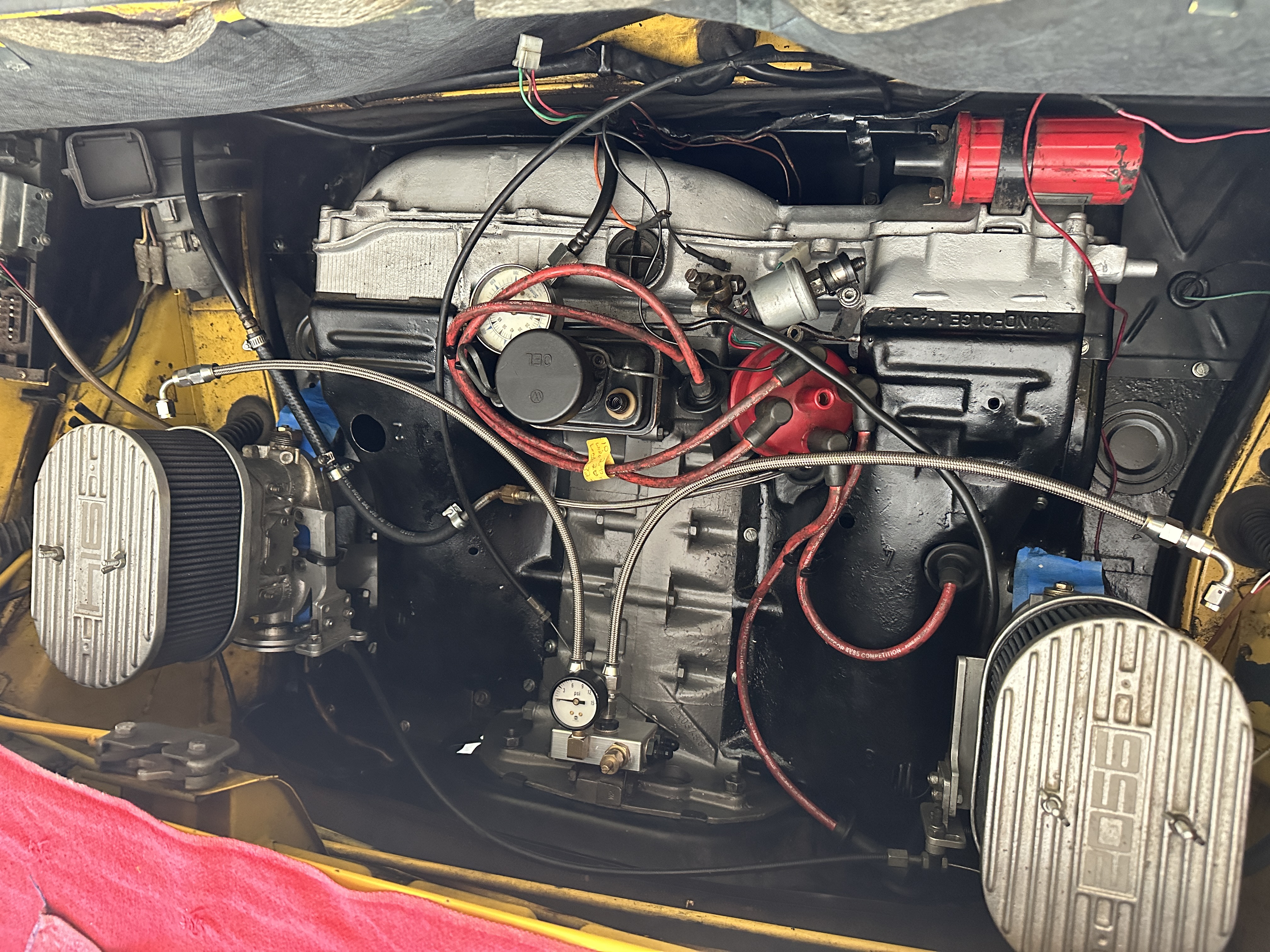

Add a PMO fuel regulator (purchased in the classified here) I made a mount to the case and insulated with silicone 1/8 washers (think GM HEI button) so heat should not be much more that engine compartment ambient temps. COOL recirculating fuel! Woo hoo. SS lines to the carbs carbs and once I'm up and running will look at the Tangerine SS tunnel lines
Waiting on some 6an to 8mm fuel parts..later today
Cheers

rfinegan   Add a PMO fuel regulator (purchased in the classif...   Aug 6 2023, 01:53 PM
rfinegan   install pics..all done under the car. including Wi...   Aug 6 2023, 04:23 PM
rfinegan   another view of the Tangerine clutch mount Gen 1 ...   Aug 6 2023, 04:26 PM
rfinegan   Lets see how I did... I add 5 gals of 93 octane t...   Aug 13 2023, 09:30 AM
