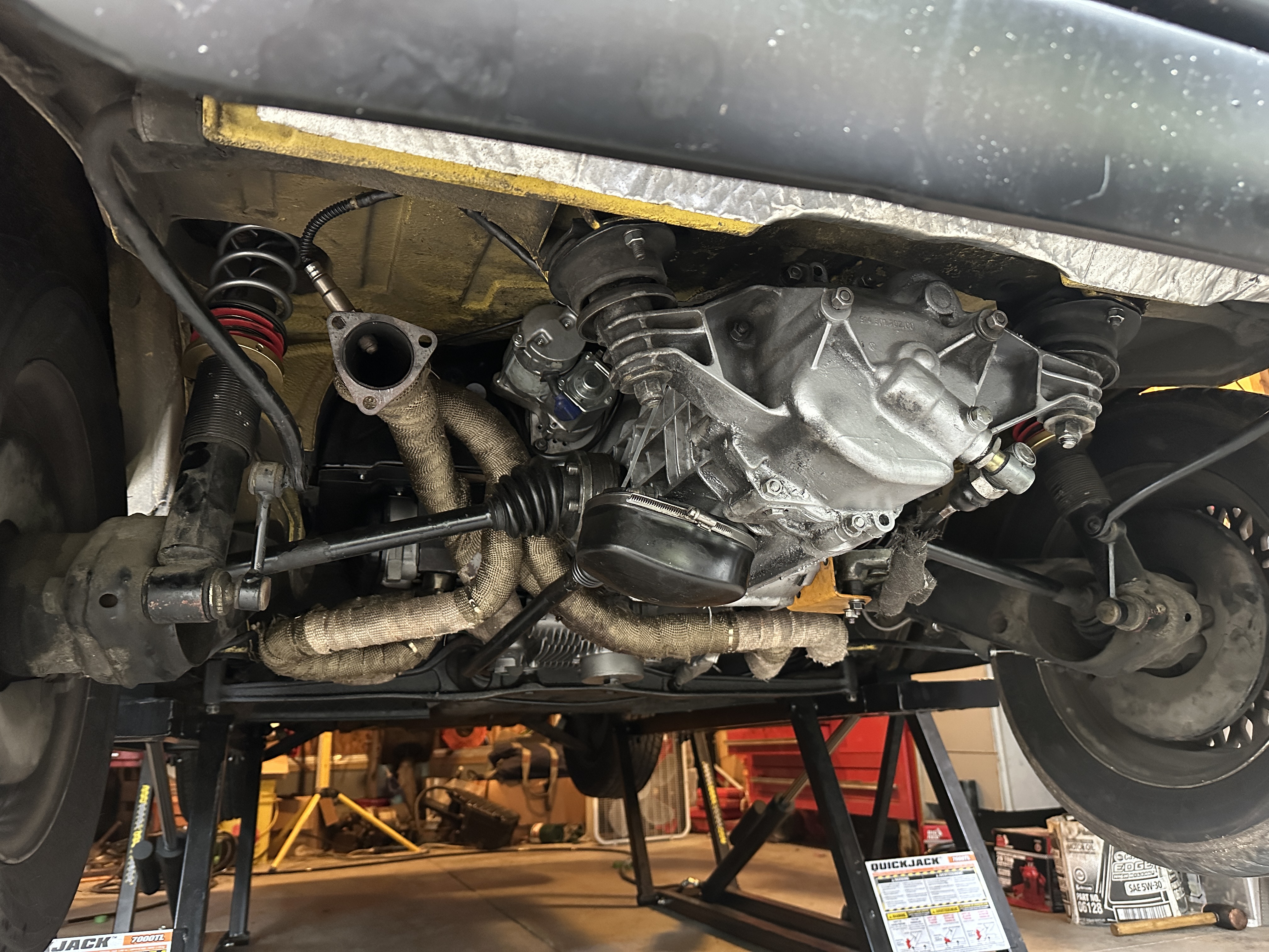

install pics..all done under the car.
including Wide band O2 and tangerine Evo muffler

rfinegan   install pics..all done under the car. including Wi...   Aug 6 2023, 04:23 PM
