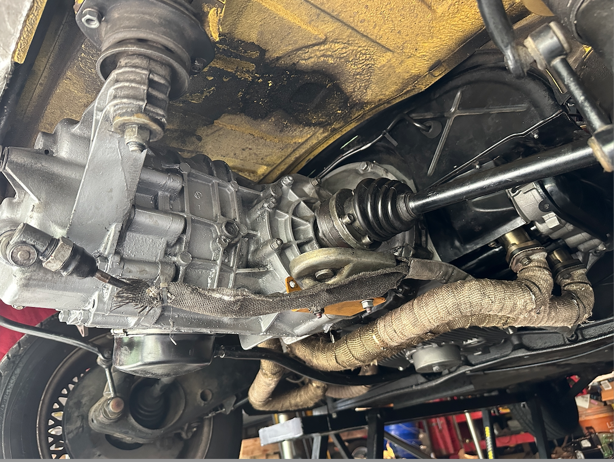

another view of the Tangerine clutch mount Gen 1
no more melted cables

rfinegan   Add a PMO fuel regulator (purchased in the classif...   Aug 6 2023, 01:53 PM
rfinegan   install pics..all done under the car. including Wi...   Aug 6 2023, 04:23 PM
rfinegan   another view of the Tangerine clutch mount Gen 1 ...   Aug 6 2023, 04:26 PM
