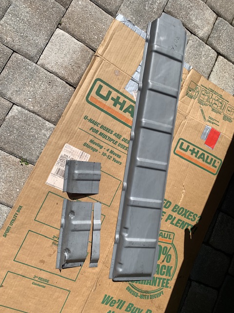

Back at it.
I made up my own replacement corner out of some other cut offs rather than cutting out a tiny section from a brand new RD piece which seemed wasteful to me. Used the RD piece as a template.
Turned out rather nice.
But it is just going to get covered up by the outer reinforcement piece that goes here.
Question for you experts. Any tips for getting the door on and off alone?
To install the outer reinforcement piece I have to get the door out of the way. It’ll probably take a couple on and offs I’m sure so looking for some practiced advise.
Thanks for looking.
