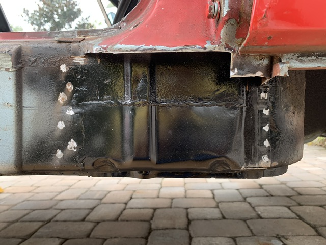

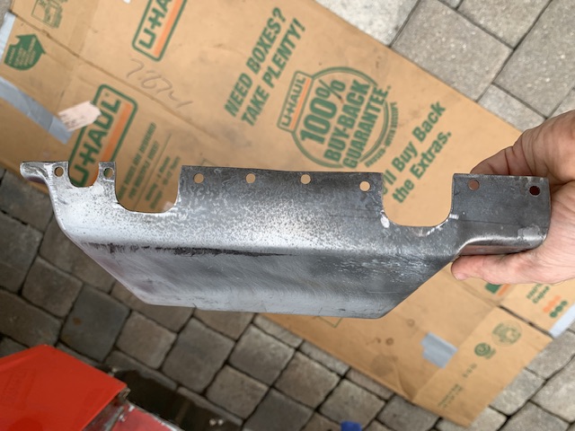

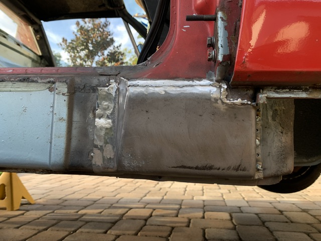

With a little help from you guys I was able to figure out how this piece should look and fit on the bottom. (IMG:style_emoticons/default/sawzall-smiley.gif)
Some (IMG:style_emoticons/default/welder.gif)
Mostly done.
