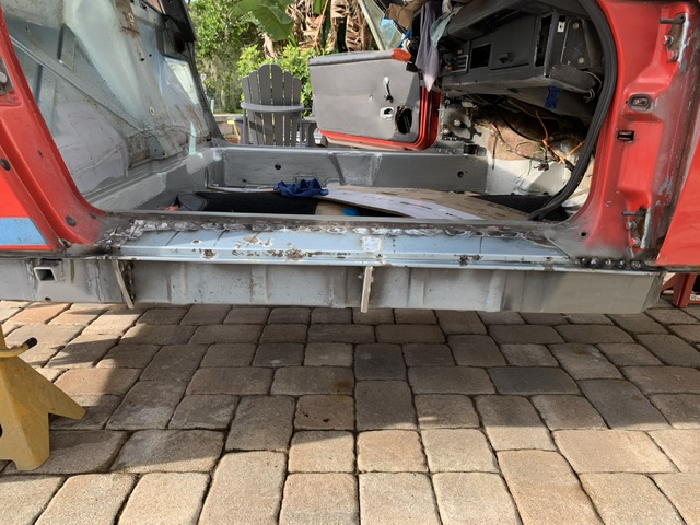

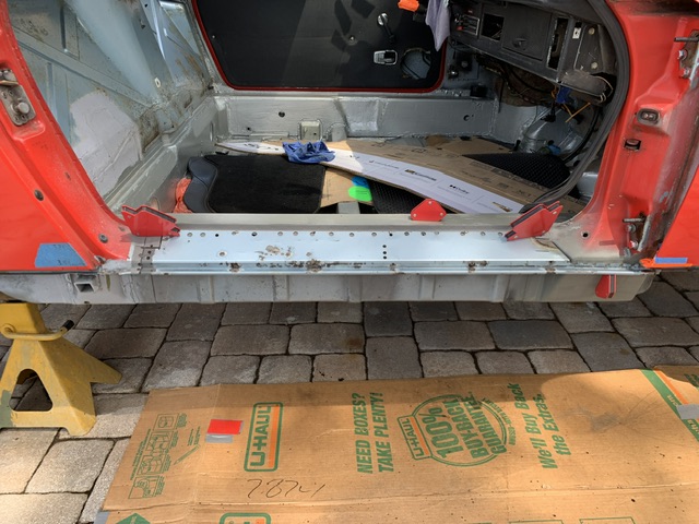

seanpaulmc   Put back the old door sill. Mostly. Almost done ...   Sep 9 2023, 06:14 PM
seanpaulmc   Sometimes a project reaches a tipping point… ...   Jul 7 2024, 07:17 PM
