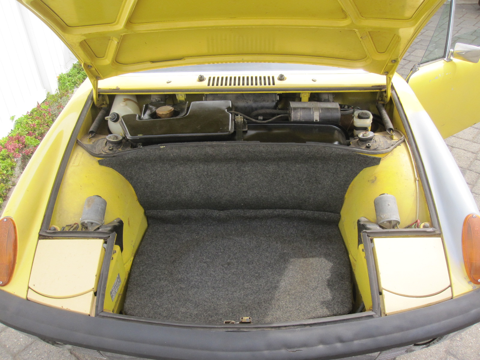

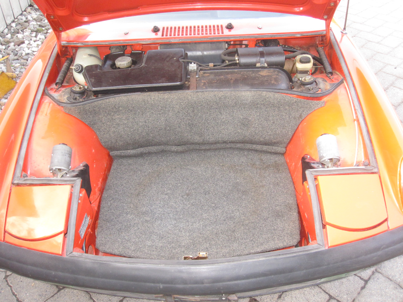

The finish of the mount is satin black.
After installation and alignment the area around the top of the mount in the trunk
is then spackled with a thick, black, tar like material. This is not seen on any 914 other
than the 914 6.
(seen on 911s too)
