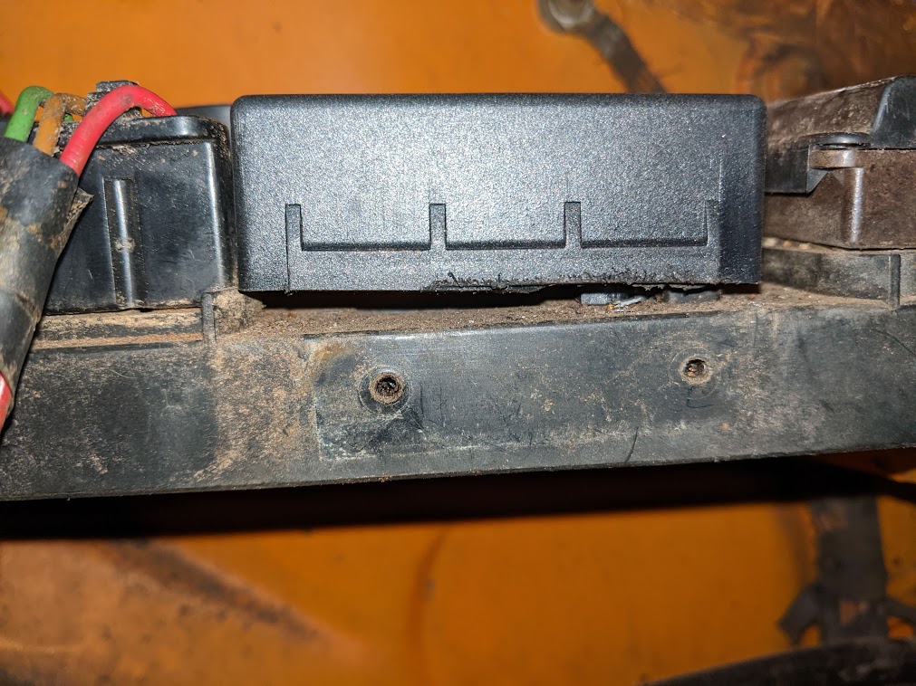

Help. I have gotten three voltage regulators from the normal Porsche Parts suppliers and none fit. The distance from edge of case to the first spade is .25 inches on my original regulator. The catalogs all show same regulator for 911, 914, and 914-6. The ones I have received vary from .4 from the edge to .65 from the edge all with same PN so will not fit in area to plug into. Anyone know the actual part to buy? My original has numbers on it in this order 0 190 601 006 AD 1/14V. The replacements show up as PN 901 603 206 02 Yes I can rewire, or maybe take both apart and move the guts, but trying to keep original and not have a wire harness to convert to get wires to new regulator. Thank you for your help. TimAttached Image

Re-reviving an old post. I would have liked to know that that part doesn't quite fit. It was nice that O'reilys can get the part within a day for just over 50$. But the tab offset is too short. So, I cut of it off. Now there's 14V at the battery. So maybe that's ok. The generator light is still on though.

Good that you have 14V at the battery. What is the voltage at D+ to chassis? The voltage across the GEN light is the difference between D+ and battery (through fuse F9). If D+ is also 14V, then with engine off, pop out the guage with GEN light, start the car and measure both sides of the GEN light. They should be the same.
