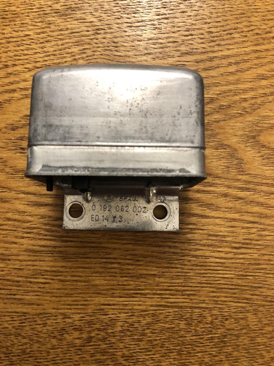

Help. I have gotten three voltage regulators from the normal Porsche Parts suppliers and none fit. The distance from edge of case to the first spade is .25 inches on my original regulator. The catalogs all show same regulator for 911, 914, and 914-6. The ones I have received vary from .4 from the edge to .65 from the edge all with same PN so will not fit in area to plug into. Anyone know the actual part to buy? My original has numbers on it in this order 0 190 601 006 AD 1/14V. The replacements show up as PN 901 603 206 02 Yes I can rewire, or maybe take both apart and move the guts, but trying to keep original and not have a wire harness to convert to get wires to new regulator. Thank you for your help. TimAttached Image

pbanders   I was going to recommend the Bosch transistorized ...   Oct 25 2016, 09:13 PM

pbanders   Looks like Hella offers an equivalent for a fracti...   Oct 25 2016, 09:26 PM
ws6   Looks like Hella offers an equivalent for a fract...   Oct 25 2016, 09:34 PM
raynekat   Be careful, not all will fit correctly. I know I b...   Oct 25 2016, 11:27 PM

porschetub   The Pelican Chinese made Hella sorta fits,pins are...   Oct 28 2016, 01:39 PM
ws6   The Pelican Chinese made Hella sorta fits,pins ar...   Oct 31 2016, 04:40 PM

pbanders   Here's another possible VR that looks similar ...   Oct 30 2016, 09:15 AM
