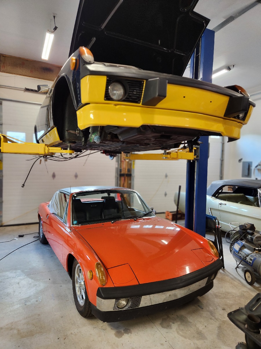

I have done a fair bit of searching here and on the web but wanted to do a final check. I've got my Bumblebee back on the road after a winter and now summer of work. I'm finishing up a few final things including replacing the ugly side stripes that were on the car. I bought the set from 914 rubber. Are these any different than other installs I see on the web?
